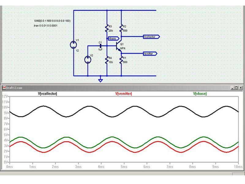

See thumbnail. Base is green, emitter is red, collector is black. Collector is 180 degrees out of phase with respect to base.
Bob S
