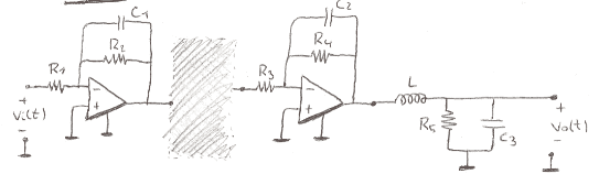

Complete the circuit in the figure in order to get a transfer function as: H(s) = k*[s(s^2+10^10)]/[(s+10^3)(s+10^5)(s^2+1.41*10^5s+10^10)].
If I split the circuit in four stages: H1(s), H2(s), H3(s) and H4(s), I obtain:
H1(s) = -(1/(R1*C1))/(s+1/(R2*C1)). One single pole.
H3(s) = -(1/(R3*C2))/(s+1/(R4*C2)). One single pole.
H4(s) = (1/(LC3))/(s^2+(1/(R5*C3))s + 1/(LC3)). Complex pole.
How can I build an H2(s) stage to include a simple zero and a double zero? How can I build a circuit like that? It cannot introduce poles!

Highly impractical, but you can add 1 op amp stage with a C input & R feedback (giving you the zero at the origin), and a second stage with a parallel L-C input and L feedback (giving you the complex-conjugate zero pair on the imaginary axis).

First, realize that your transfer function is not realizable in any practical way. That's because it calls for zero gain at w = sqrt(10^10) = 1e5 rad/s or 1e5/2pi Hz. That is impossible to get and still have finite gain at other frequencies. So this problem is a "textbook" problem & so it's OK to use impractical circuits like what I gave you.
The s in the numerator would be made part of a Ts/(Ts + 1) circuit so you'd get you zero at the origin plus your pole at s = - 1/T. That's just a series R-C in the input and R in the feedback:
Vout/Vin = -Zf/Zi = -Rf/(Ri + 1/sC) = -(Rf/Ri)sRiC/(sRiC + 1).
There are fancy networks (like 3 R's and 2C's in the feedback etc.) for synthesizing complex-conjugate zeros (or poles) but never if the poles or zeros have to be right on the imaginary axis, since that implies an infinite-Q circuit.

It's not difficult to place a complex zero right on the jw axis (or close to the jw axis on either side). Twin-T and bridged-T networks are one way to do it.
