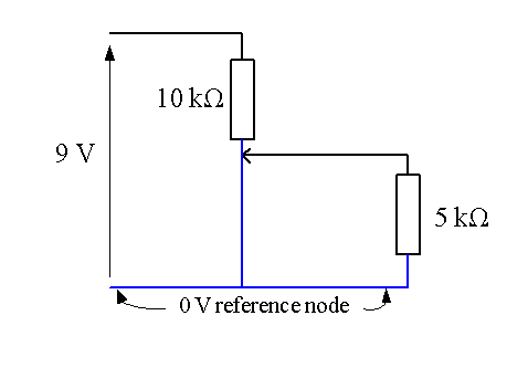

The circuit of (attached file) shows a 10 kΩ potentiometer with a 5 kΩ load. Determine the position of the slider on the ‘pot’ when the voltage across points ‘XX' is 3 V.
I can't figure out how you would find the current first without knowing total resistance?
Any help would be greatly appreciated thanks.

Write an equation for the output voltage in terms of the wiper position. Use some variable like "x" to represent the fraction of the pot resistance that is in parallel with the output resistor. Make x go from 0 to 1, to represent that fraction (as the wiper goes from the bottom to the top of the pot. "x" multiples the total resistance of the pot...
Do i not need to find the currents? I have 0.6 mA going through the 5kΩ load resistor. I'm not sure about that equation? Please help?
It may help to consider the potentiometer as two separate resistors, x*10k and (1-x)*10k. If you redraw the circuit, you now have three little resistors that may be a little easier to analyze.
You should then be able to put the bottom resistors in parallel, and form a voltage divider (so no currents required!) The method I used means that you'll have to eventually solve a quadratic equation, but only one of the roots makes sense.
If we call the resistor in series R1 and the resistor in parallel R2 and the 5kΩ load resistor R3. Can i have R1+R2=10kΩ? And because R2 has a voltage of 3V and therefore R1 has a voltage of 6V can i say R2/R1=3/6 and R2=0.5R1? I'm still a little unsure?

No, sorry. Re-draw the circuit as suggested by MATLABDUDE. Show explicit resistors for R1 and R3, and divide up R2 into 2 separate resistors (divided at the wiper contact). Label the resistors as suggested, and write the voltage divider equation.
Please show us your new figure with 4 labeled resistors...
