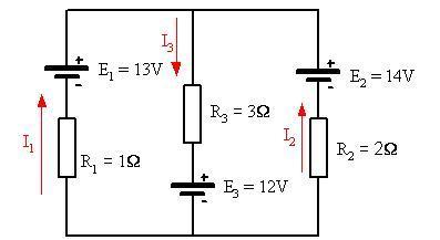

Calculate the value of the current through the 12V battery shown in figure (attached).
V = IR
I1 = I2 + I3
I've calculated the current for the left hand loop, see below:
Loop 1:
E_1- E_2- V_1- V_2=0
E_1- E_2= V_1+ V_2
E_1- E_2=I(R_1+ R_2)
13-12= I (3+1)
1=4I
1/4=I
I=0.25A
I understand it's a process of doing the same to the right hand side and then subtracting the two sides? I'm just unsure as to when i should be adding the voltages and resistors and when i should be subtracting them.Is it related to the direction of the current and voltage potential? If anyone can help here it would be greatly appreciated. Thanks.

You have two loops which will influence each other in terms of voltage and current. So a single equation for one loop isn't going to capture the interplay.
What circuit analysis methods have you learned?
gneill, thanks for your help.
We've been shown the branch current method.
Okay. It looked as though you were attempting to apply Kirchhoff's Voltage Law (KVL) around a loop, but branch currents are good too! That boils down to Kirchhoff's Current Law (KCL), which states that the sum of the currents entering a given node of the circuit must equal the sum of the currents leaving that node.
Your circuit has three branches and two nodes. For the nodes, label the bottom horizontal conductor as "ground". Label the top horizontal conductor "Node A".
If you happened to known the voltage at node A (with respect to ground), VA, then you could calculate the current through each of the branches. For the leftmost branch, for example, you 'd have I = (VA - 13V)/R1. So how to determine VA? That's where Kirchhoff's Law comes in.
Assume that there's a voltage VA at node A. Write the equation for the sum of the currents leaving Node A for each branch connected to that node. I gave you the example for the first branch. Solve the resulting equation for VA. Once you know that voltage you can determine the current in each of the branches (including the one you're interested in).

One problem I just spotted (should have caught it sooner) is that, according to your assumed current directions you should have I3 = I1 + I2. This is going to change your result, since you've written I1 = I2 + I3.

You'll have to go back and rework the loop equations where you've used the current sum relationship. The current through E3 is not zero.
Thanks for all your help to date. I've come up with a final figure of 0.95A for I3. Does this seem right?
Unfortunately, no :cry: Something must have gone awry in the math.
How about one more attempt, from the beginning? I'll get things started, using the equations that you've written before:
KCL for top node: I3 = I1 + I2 ...(1)
KVL for left-hand loop:
13 - 3*I3 -12 - 1*I1 = 0
Replacing I3 using (1):
4*I1 + 3*I2 = 1 ...(2)
KVL for right-hand loop:
14 - 3*I3 - 12 - 2*I2 = 0
and using (1):
3*I1 + 5*I2 = 2 ...(3)
You should be able to solve (2) and (3) for I1 and I2, then use (1) to find I3.

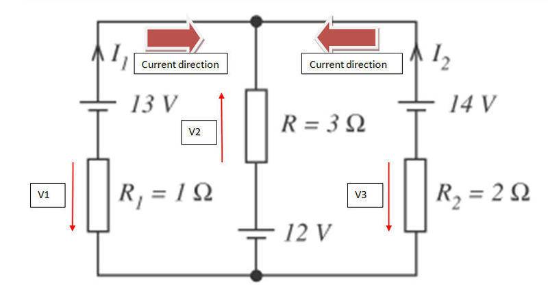

I think your I2 should be
-0.4545 which changes your I1 to to 0.8409 giving I3 = 0.39 A.
This would affect your answer when working out the power dissipated on each resistor wouldn't it?

ok so i re calculated the current as follows:
I1 = 0.09091 A
I2 = 0.45455 A
I3 = 0.36364 A
do these values look more accurate?
I1 = 0.09091 A
I2 = 0.45455 A
I3 = 0.36364 A
Yes, their magnitudes look okay.

How do we get a negative current in I1? does this mean the direction of current is opposite to that shown on the diagram and does the law now change to I3 = I1 - I2?
Nothing changes. The equations to solve the circuit were based upon assumed current directions that may or may not turn out to be correct assumptions. No matter, the math takes care of such things. If a current that was thought to flow one way but turns out to flow in the opposite direction, it will end up with a negative value. No big deal. All the equations still apply exactly as written, just use the values obtained.
