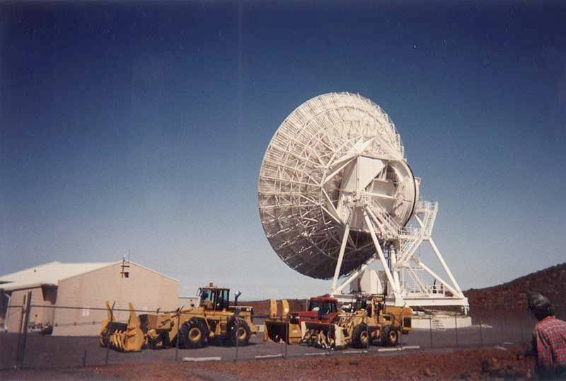

I went to the top of Mauna Kea in 1999 and visited the Keck's and a couple of the other scopes up there. pretty awesome :)
Half way up the road to the top is a radio telescope that is linked with one in the Andes mountains in Sth America. It gives a baseline of 1000's of kms awesome resolution at radio wavelengths.
The other thing that can be done with radio telescopes ( not sure about optical scopes) is you can take reading on a deep space object say today. then in 6 months time do the same again, intergrate the data and you have the resolution of a telescope with the diameter of the orbit of the Earth around the sun!. Now that's serious resolution abilities.
