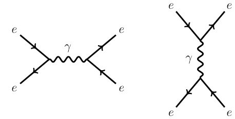

The four vector J_μ is the source of the Electromagnetic potential four vector A_μ. If I wanted a source term for the Dirac equation (not that I think there is such a thing) could it be (must it be) a spinor source term (what ever that means)?
Related question, consider the two Feynman diagrams below. In the first diagram the current is a source of a virtual photon. In the second a photon is destroyed and a electron positron pair is produced. Can I think of the virtual photon as being a source for the Dirac equation?
Diagram from,
http://www.google.com/imgres?hl=en&...49&start=12&ndsp=15&ved=1t:429,r:6,s:12,i:116
Thanks for any help!

Presumably a source term would replace zero on the right hand side of the Dirac equation:
(i\gamma^\mu\partial_\mu - m)\psi = 0
Then yes, for the indices to work out, whatever goes on the RHS must be a Dirac spinor.
The Lagrangian for a Dirac field coupled to the electromagnetic field is
\bar{\psi}\{i\gamma^\mu(\partial_\mu - ieA_\mu) - m\}\psi
If you proceed from this Lagrangian to the "classical equation of motion", whatever that means for a spinor field, you get
\{i\gamma^\mu(\partial_\mu - ieA_\mu) - m\}\psi = 0
or
(i\gamma^\mu\partial_\mu - m)\psi = -e\gamma^\mu A_\mu \psi
I guess if you like you can think of the RHS as a source term, but this interpretation is maybe not so clean since the "source" of psi depends on psi.
In QFT I think we prefer to speak of generalized "interactions" rather than fields being "sources" for one another. As you are seeing, the same interaction term
e\bar{\psi}\gamma^\mu A_\mu \psi
can do many things. It can let an electron produce a photon, or let an electron absorb a photon, or destroy an electron-positron pair and create a photon, or destroy a photon and create an electron-positron pair, or destroy a photon, electron, and positron, or create a photon, electron, and positron. Lorentz invariance forces us into a theory where all these processes are essentially equivalent and described by the same term in the Lagrangian.
