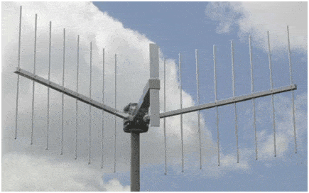

Here is one design using reflector rods instead of a flat metal reflector: Doing this cuts down wind resistance. (Data from the ARRL Antenna Book):
Frequency 220 MHz
Reflector rod lengths: 30 inches
Reflector spacing (distance between reflector rods) 3 inches
Side length 52 inches (so there are 17 rods on each side of the reflector)
Angle between two sets of rods: 90 degrees
Spacing from dipole to the corner of the reflector: 25 inches.
A dipole for this frequency would be about 25.75 inches long
Like this:

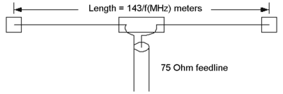

I need a Circuit Diagram and Block Diagram.Another question ..Corner reflector antenna will work perfectly For which device?
Thanks
A dipole is connected as in the above diagram.
The feedline would connect to your TV set.
A corner reflector is used for single band communication although for about the same cost you could arrange for the reflectors to be in a parabolic shape and hence get more gain. It would then work like a dish antenna but only curving in two dimensions.
Does the rectangle in the middle represent a Balun?

No, it looks like a mechanical support. Just a joining point, like the ones at the ends of the dipole.

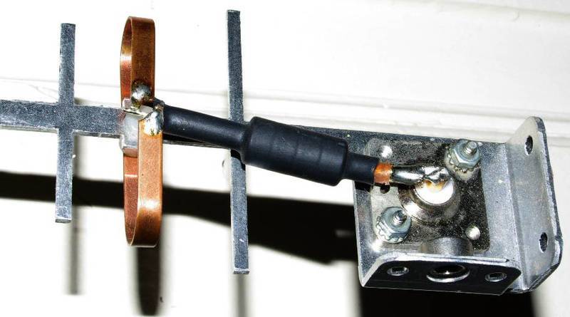

One possibility would be to add a number of ferrite toroid rings on the outside of the coax near the antenna feedpoint. With suitable ferrite, this may be a simple enough solution
Thats a neat trick and is quite effective even up into the GHz range. I have a commercial 12 element, 2.4GHz Yagi which uses that method for a BALUN right at the feedpoint and they are just covered with some heatshrink
Dave

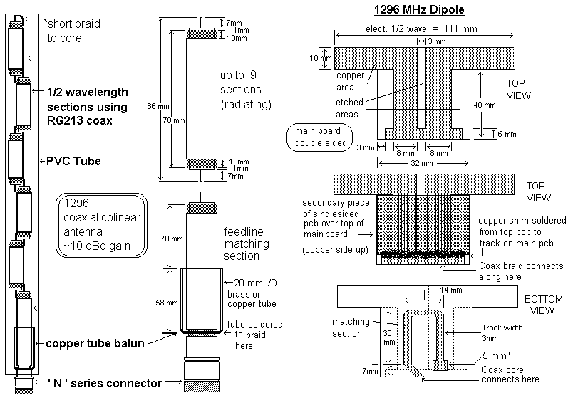

In another life, when I worked for Telecom New Zealand, we were installing 1500MHz radomed Yagis in rural regions for telephone access. after a couple of winters, these Yagis started failing in mass, they just couldn't handle the freeze/thaw conditions on snow/ice covered mountain/hill tops then the hot summers that followed and the radomes and mounting parts were cracking and breaking.
Telecom switched to 1500MHz corner reflecters which us guys built "in House". I even scaled the PCB dipole and matching section for use on 23cm band .
see the right side of the pic...
the left side antenna is a coaxial colinear for 1296MHz
Dave

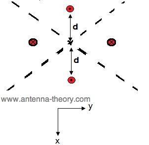

This is the effect you get with a corner reflector. It is almost identical to the situation of two plane mirrors at right angles with a lamp between them:
http://dl.dropbox.com/u/4222062/corner%20reflector.PNG
A viewer at the top right would see 3 images (red dots) if he was close enough, but further away, he would see varying light levels depending on how the 3 images combined at that angle.
The corner reflector is slightly different to the mirror situation because the distances are comparable with the wavelength of the radiation, so the phases of the reflections are important.
You can also see that the corner reflector triples the power from the dipole radiator, at most, so the maximum gain is 4.7 dB. (10 log (3) = 4.77 dB).
You would have to wonder why anyone would build one of these when changing the reflector to a parabolic cylinder would give a lot more gain for almost the same wind resistance.
