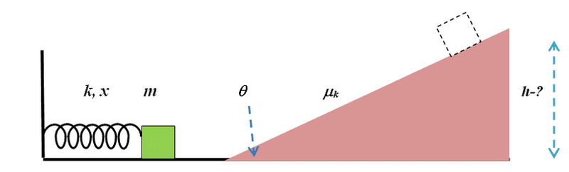

A small block of mass 0.8 kg is launched by a compressed spring with force constant k=400 N/m. The initial compression of the spring is 0.12 m. The block slides along a horizontal frictionless surface and then up an inclined plane that makes an angle θ=30° with the horizontal. The coefficient of kinetic friction between the block and the inclined plane is μk=.2. (See the attached picture.) Find the maximum vertical height h reached by the block.

I need help understanding where I went wrong and how the problem should be done.
Uspr=kx2/2=(400)(.12)2/2=2.88
K=Uspr
K=1/2mv2=1/2(.8)v2=2.88
v0=3√(2)/5
I assume right is in the +x direction and up is in the +y direction.
G=-7.84
G=-Ny=-Ncos(θ)
N=-G/cos(θ)=7.84/cos(30°)
Ff=-μkN=-.2*7.84/cos(30°)=1.568/cos(30°)
Ftoty=ƩFy=7.84/cos(30°)-7.84-1.568/cos(30°)=-.5977
v0y=3√(2)cos(30°)/5=3√(6)/10
Ftoty=may
ay=Ftoty/m=-.5977/.8=-.747125
vy2=v0y2+2ayh
vy2=0 when the block is at its maximum height
0=(3√(6)/10)2+2(-.747125)h
1.49425h=5.4
h≈3.613853104

For objects accelerating along an incline, you will be much better off choosing one of your axes along the incline and the other axis perpendicular to the incline. That way, one of your axes will be parallel to the acceleration vector of the object.

The main problem seems to be in your expressions for the x and y components of the gravitational force Gx and Gy on the incline. Check your notes for other inclined plane problems.
Your method 1 looks good except for the expressions for Gx and Gy.
Your method 2 is incorrect because you have double-counted the effect of gravity. The work that gravity does as the block goes up the incline is equal in magnitude to the change in Ugrav. If you include both the work done by gravity and the change in U, then you are essentially including the work done by gravity twice.

I use the coordinate where the direction of the normal force is +y and up the incline is +x.
On the slope, is Fx positive or negative based on your direction for the positive x-axis?
So, should the acceleration be positive or negative as the block goes up the slope?
Is this correct?
Gx=-mgsinθ and Gy=-mgcosθ
The force and therefore the acceleration are negative.

Yes. That looks good.
Thank you so much!
So that means N=-mgcosθ
Fx=Ff+Gx
Ff=μkN=-μkmgcosθ and Gx=-mgsinθ
therefore, Fx=-μkmgcosθ-mgsinθ.
F=Fx=ma so a=Fx/m=-μkgcosθ-gsinθ
vf2=0
vf2=vi2+2ad so 0=kx2/m-2(μkgcosθ+gsinθ)d and d=kx2/(2mg*(μkcosθ+1sinθ)). sinθ=h/d so h=dsinθ=kx2sinθ/(2mg*(μkcosθ+1sinθ)).

Doesn't the value for h seem a little small?
I agree with your final answer. The numerical calculation would be simpler if you wait and substitute numbers into your formula for h:
You don't need to worry about finding the velocity at the bottom of the incline if you set it up as Ef = Ei +Wf, where the initial point is where the block is compressed against the spring and the final point is where the block comes to rest on the incline.
Ef = Ug = mgh
Ei = Usp = kx2/2
Wf = work done by friction = -fkd = -μkmgcosθd = -μkmgcosθh/sinθ
