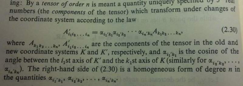

I dug up my old book, this is how I learned them:
So it looks like my definition does rely on the idea of coordinate systems.

PSarkar said:
May be you misunderstood my post. A tensor is a multinear form with the field being the real numbers (at least the way I learned it). You only get a matrix or a multidimensional array representation when you pick coordinates but otherwise they are coordinate free just like linear transformations. Furthermore, they are not the same thing as the multidimensional arrays, just like linear transformations are not matrices (The matrices are only a representation when you pick coordinates. You can formalize it as a linear map from the vector space of linear transformations to the vector space of matrices, given some basis). So that's why I was saying that strictly speaking, vectors are not tensors but can be put into a one to one correspondence with tensors of type (1, 0), but even so, such a map is not unique.
May be you learned tensors in a different approach. The approach I am familiar with is the way it is done in Calculus on Manifolds by Michael Spivak. I have also seen an even more general approach in abstract algebra books starting with tensor products of modules and vector spaces.
Before talking definitively about what tensors are perhaps you should read up on those abstract algebra definitions you mention earlier :rolleyes: In any case you are consistently getting the type convention for tensors wrong. Tensors of type (1,0) are elements of the vector space while tensors of type (0,1) are elements of the dual space. The way you learned tensors focuses entirely on this dual space perspective since it leads quickly to differential forms, but it is lacking in generality.
