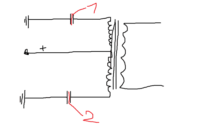

so here is the circuit , what do you think , in such a circuit changing the permittivity 180 degrees out of phase would achive charge flow back and forth ?
I attached a schematic I just did in paint, excuse me for the quality and the blurred lines, I guess the vine is stronger this year
What did you want the circuit to do?
I presume that you want to cary the C's and, thus, vary the charge at each end of the transformer primary, resulting in an induced AC on the secondary. The 'detail' of how you will vary the C's is missing, of course and that would be the difficult bit.
It doesn't appear to be achieving anything.
It's a non-starter as a 'power supply' circuit because it would be, necessarily, very inefficient, for the reasons I gave, involving the inherent power loss. The Power to drive it would all come from the circuit driving the diodes. There is no DC path from the (DC) Battery ("+") so it can't deliver any power. The power supply is just providing 'bias'. A power oscillator circuit would be more applicable for driving the transformer.

Ok this was a very rough picture of what I mean , possibly the constant +ve supply kills any charge oscillation that might occur if the capacitors would be varied in capacitance one by one , one after the other.
It might only look like I'm talking about a PPM machine because I am not aware of all the mistakes I could or have made , I definitely don't think in terms of PPM , I know enough physics to know that doesn't work.
But why perpetual motion ? I was just thinking that, well you can run a transformer with a current that runs back and forth and increases and decreases in strength periodically just like an AC sine or square wave , but the same could be done by moving charges which is the same current back and forth using the attraction of repulsion of the electric field , rather than a direct current path,
Is it just me or I kinda thought that changing or varying field both electric and magnetic can transfer energy too , by the way that is how the transformer works as it too doesn't have a current path nowhere through it's core.
Ok , can you tell me sophie what exactly I am ignoring because it seems I am not aware of it as if I would I wouldn't repeat it.
As I have told you, the energy can only come from the mechanism that changes the values of the Capacitors. You cannot produce power without putting some in and you have not specified how you will do it.
What he said - that's the pmm part.
It's the most important bit.

A transformer can only transfer energy from the primary to the secondary if there is a time and/or polarity varying current in the primary, right ? right.Normally we have semiconductor switches that switch the + to - and do that and flip the sides of the primary on each cycle so that the transformer would see not only amplitude varyation but also polarity variation , like in a H bridge smps.
My idea was to have two capacitors attached at each end of the primary and both tied to ground , but at any given amount if time only one of them charges up fully while the other is if not totally empty (the ideal case) then atleast with a much lower capacitance , and so by charging one cap and discharging the other we could achieve a constant charge flow back and forth, the power to movre these charges as the transformer would be under load would come from the electric field present at the capacitors , the one capacitor which would charge up at an given moment would suck the charges in aainst the back emf of the transformer , is that right ?
I ca't understand what is so wrong about this reasoning?
My hair is still firmly attached at the moment. haha
It seems you still haven't cottoned on to the energy deficit in all this. You only talk about charge and current. You don't even include a load (resistor) on the output of your transformer. Without the load, the whole exercise is pointless - you must agree.
The following is an attempt to show that Energy is lost to the load and has to be replaced.
First of all, how we choose to change the Capacitance of our Capacitor is not relevant.You seem to imply that changing the dielectric is, somehow, different from moving the plates. In terms of the Energy, there is no difference. It is just one extra link in the explanation which adds complication. I will use moving the plates in this instance because it's easier to discuss (one less practical difficulty).
1.The plates on the capacitor start charged and connected to a source of DC.
2. We move the plates apart (they are attracted to each other so work is done on them) and the Capacitance decreases. Charge flows out of them, through the transformer coil into the battery and a current flows through the load resistor due too the transformer action. The energy dissipated in the resistor is lost for ever from the circuit.
3. We let to plates come together and the plates do work as the Capacitance increases again. More current flows and energy is dissipated in the load.
4. Over the cycle of operation, work is put in and taken out of the plates. BUT less work is got out than had to be put in. This corresponds to a net amount of Energy dissipated on the resistor (plus other losses)and that needs to be put into the device during each cycle.

Ok Sophie , here are my answers.
First of all I never said that changing the dielectric would be basically different than moving plates , I understand it;'s the same thing just one is longer lasting solid state the other is mechanical and probably less efficient that's all.
Also excuse me for not telling this but I never considered this apparatus would not need energy input , ofcourse it would need energy input as the charge flowing back and forth through the transformer would be lost r better said transformed to the secondary which would be under load , say a resistor.
So +ve attached and a load on the secondary was in my head all the time I just have been focusing more on the primary driving idea as the other factors like energy supply and load is nothing new.
So on each cycle one cap would charge up the other would discharge and the lost charge due to emf and induction on the loaded transformer would be replaced by the incoming charge from the +ve supply just as in other cirucits.
Now , if only the dielectric could be made to change like in a mosfet the gate opens and closes the transistor based on applied charge and electric field inside the device , it could actually be a pretty efficient and cool device would it ?
So the pirnciple works, +ve supplied, transformer if its properly made, is a efficient device as we know it, a capacitor also has no problems in terms of efficiency , so the only quesion is for the dielectric and how to vary it , I;m not saying that such a material is possible to make , also I;m not saying how good it wuld be as I don't have nor the calcualtions nor a physical prototype to back it up , I am just asking you to do a little imagine thing.
So if for example a dielecric could be made , not saying it's possible just if, that varies when a charge is applied to it then , I could use a circuit which just drives some charge to one caps dielectric and then back into the other , pretty much like a gate controller IC applies and drains the charge from mosfet gate to either open it up or close it.The charge is not lost in that case , the energy either , it;s just transferred from one place to the other.
Ofcourse as I said I don't know how would the material need to be made to inherit such properties like varyable permittivity upon applied charge and it would probably need to be some mixed material as you cannot apply a charge to a pure delectric.
Well I hope you understand that this is more about the idea than a physical device, and yes some physical moving plates or other device like that would be very innefficient ofcourse , also would probably occupy too much space for a given power output , so the only thing that comes to mind is a special type of dielectric, it it's possible ofcourse.

I can see that your circuit could be made to operate as an inverter circuit if you swapped these non-existent Capacitors for Mosfet switches. One big difference, however, would be that the power would come from the battery that's in the diagram (you would have DC paths when the mosfets are on). In your proposal, you need another source of power.
Your capacitor would need to be made from a form of Unobtanium that is often proposed in Forums. I could also suggest a special form of core for the transformer that could alter the permeability of the core and, thus, produce a varying voltage.

well I thought about these caps because ofcourse transistors are really good and they do fit in many many applications , it's just that in power supplies I have never liked them for one reason , using high frequencies they need very very accurately made transformers and other drive electronics otherwise they go smoke and flashes as every time they are turned on they form a physical current path from + to - and we all know that.
a capacitor on the other hand charges up and down but as long as you don't abuse them with overvoltage , overheating or other easy to watch out things you could change the frequency put overload on the secondary and many other things and nothing bad would happen , because all that can happen is the cap gets charged less or faster or slower but that doesn't matter as it won't destroy the device, I kinda have sympathy towards rugged and simple inventions, devices etc.
what do you mean by another source of power ? apart from the rectified +ve and ground or battery +ve and negative what other source of power are we talking about ?
yes I agree i could have made my OP better , but then again what would that change? As in the end I still desire to make a " wacky" hopefully great way of making AC from that DC.
You can answer this question yourself if you can explain how that battery, on your diagram can actually deliver any energy (yes, energy) into your system. It's a DC battery, AC coupled into a circuit. THINK!

the only reason a battery could not work is because a capacitor has no physical charge flow through it , so the positive charges even though being attracted by the negative ones would want to flow towards them they would stop doing so with time because in a battery the charges need to physically interact, is that the reasoning ?
ok then what would happen in the case of a rectified mains power supply , would it also be a no go?

@Mr.Bomzh
You have not read a word that I have written about the energy situation. You have been so sure that your idea is OK that you haven't stopped to think it has a fatal flaw. That battery can give you NO ENERGY, the way you are using it. Do you not realize that?
Energy delivered = Net charge times PD. There is no net charge so no energy.

wait so you mean that because the capacitors altogether have a total amount of charge which is just passed back and forth but cannot get bigger or change because it has nowhere to go other than just from one plate to another so no new charge can come in and no energy with it , is that what you are trying to say ?
  • #39
That's what I have been saying and implying all along. You have just chosen not to read it.
The energy that can be transferred must come from the process of changing the Capacitance - which is what I have been telling from the start.

Still it kinda puzzles me , okay the total amount of charge doesn't change it just travels frokm one side to the other , but isn't this more about fields , because as the charge goes from one side where the charged cap is to the other where the empty cap is it goes through the transformer primary and with a load on the secondary it endures a back emf which should , I don't knwo how to say this properly, diminish the strength of the charge , as energy was put into the secondary so it had to go away from the primary side, now as this has happened without the +ve supply there would be much less voltage to charge up the other cap as some of it would have dropped while passing through the primary , so the +ve is there to deliver this missing piece so that the cap could get charged to the same value the one before it did?
Ok I guess there will be a problem in my reasoning like 99%, could you please explain this ?

It's about Potential, rather than fields. E = QV
The charge changes as the Capacitance changes. ("Strength of Charge" is not a meaningful quantity.)
At the risk of repeating myself, work has to be done ON and / or BY the capacitor in order to change the Capacity because charge will flows in and out of it. There has to be a source of energy to make up for any difference in the Energy In and the Energy Out, over the cycle. That source is not the battery - as you have it connected. Thise two capacitors just take and deliver charge in and out of the battery. The net flow of charge is zero and the net flow of energy is zero (from those battery terminals). But there is a flow of energy from the (separate) source that is causing the C to change and the resistive load on the secondary.
You are still trying to make up and apply your own rules about this and they are wrong /inadequate. Just use the accepted rules of circuit analysis (learn them for the first time if you need to) and the logic of what will and won't work will become clear.

Ok , instead of guessing myself , maybe you can tell then what is that source if not the battery ?

YOU have to provide the energy from somewhere or nothing will happen. That's what the motor idea, and others, was all about. Try reading back through the 40 or so posts. It's all been said several times back there. You just ignored it every time.
You kept denying you were talking PMM but that's exactly what you have been doing - without realising it.

Oh ok , then the energy that would be put into the dielectric change would be the one which would be transferred through the charge flow between the plates through induction through the core to the secondary into the resistor? I hope I finnaly got it , if not then I will take a time off to catch some breath and think about it

so the field is involved after all as the energy put into the dielectric change does not physically touch the charges that flow between the positive plates of the primary yet it affects them , still geronimo ? :D

Your proposed circuit, as you have drawn it, has no loss mechanism because you don't include the load. Ignore the non-ideal component resistances.
The huge inefficiency is in getting the Capacitance to vary without any internal losses. We're talking Hysteresis here. You unobtanium would need to be stressed in some way to change its dielectric constant - rubber?? Plastic with bits embedded in it? Radiated with X-rays? The sky is the limit but any of those methods involve wasting energy just to produce a change in C. There are Varactor diodes which are reverse biased diodes in which the depletion layer varies as the bias voltage changes. Relatively little loss in a reverse biased diode but, on the other hand, only a a variation of a few tens of pF. That would necessitate a pretty high operating frequency and there are losses associated with that.
I think I'll stick to conventional ideas for inverters until your onobtanium becomes obtanium. Switching components for inverters are required to have very very low on-resistances to avoid losses and overheating. The same (or equivalent) would be needed for your system.
But it is true (and you can console yourself with this) that the effect you are considering could be the basis of a measuring device- with a small signal coming from a transducer which could measure, say, pressure. HAHA I just realized that an electret microphone works in more or less the same way - varying capacitance of a vibrating foil as sound hits it- but still no fancy dielectric trick.
Keep up being inventive but don't forget to learn all the basics if you want to make your in-head inventions work in-practice.
