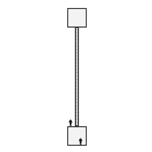

Hi everyone, here's the situation: Everyone knows that you can simulate artificial gravity by rotating a space ship. Usually these scenarios include an atmosphere with regular air inside. I know that the inclusion of air has an influence on the effects inside by way of friction. How different (if at all) would it be to do the same experiment but in a vacuum.
I've made an animation to illustrate the point.
What would happen to the man standing on the outside of the ship? Would he be able to stand there perfectly perpendicular to the ground or would the coriolis effect make him lean?
What would happen if he were to jump straight up?
I'm working on a video game that takes place aboard a spinning space ship. In one of the scenes the player has to go outside and climb a ladder through the spine of the ship. I'd just like to know if that's possible and if yes, what would it be like, compared to regular gravity here on Earth.
There is no difference between what happens to each of the people. If he jumps "straight up", as it appears to him in the rotating frame, then in the stationary frame his velocity vector gets an extra component towards the centre of rotation, but the net vector still points mostly tangential to this. So he leaves the surface, but his straight line motion quickly intersects with the curved path of the box again, so he lands back on the box.
The air is not necessary for this; i.e. you don't need any friction to keep synchronised with the rotation of the box, because it is just rotating at constant velocity. If you jump, and then the box suddenly stops rotating, then your path will no longer intersect with the box and you are "flung" off into space. Of course if you don't jump and the box stops then much the same thing happens, except your legs get pulled out from under you as the ground zooms off to one side.
Edit: As for the Coriolis effect, I don't believe this is something one can "feel". In the rotating frame it "acts" uniformly on your whole body, and has no r dependence, so you don't feel it just like you don't feel gravity pulling on you when you are in free fall. So it won't make you lean or any such thing. Actually, it is velocity dependent, so you might feel some funky things between parts of your body moving at different velocities relative to each other, like if you wave your arms or something.

Thanks a lot for that detailed explanation and the quick reply. That helped a lot! That link was very helpful as well.
I believe the ship is big enough to reduce those effects considerably. It's about 300 meters long.
