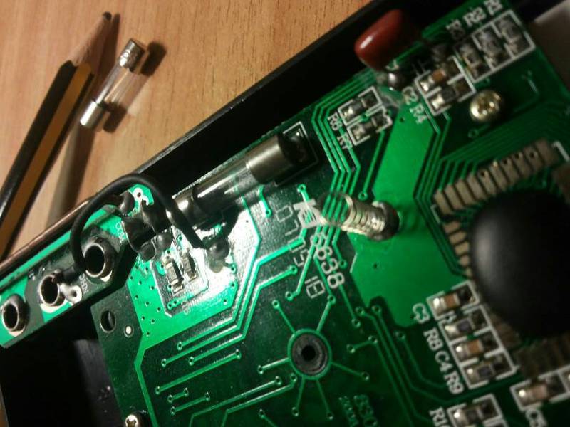

Since it's my first time playing around with a multimeter, i finally short-circuited it, tried to measure a current incorrectly, so now my fuse is burnt...
The problem is, the fuse is soldered on my multimeter. What should I do, get another multimeter or get a soldering gun and try to fix it? (the latter seems more exciting, but it will suck if it won't work)
Thanks in advance...

Can you post a photo? There might be another way to handle it...
Here you go
You might be able to make 2 little spring clips to hold the good fuse up against the blown fuse's body, just below it on the PCB (as long as it doesn't short to any other exposed metal or parts). As long as the fuse ends are touching each other (the fuses will be in parallel), it should function fine. It's a pain that they soldered the fuse to the PCB!
If you do use a soldering gun (maybe you can borrow one from someone), you will need solder wick to clean off the existing solder to free up the blown fuse.

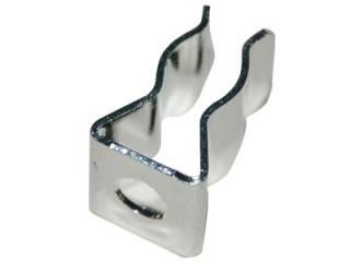

Well, an option would be to use four of the clips below, and use short screws to connect 2 each back-to-back. Then clip the good fuse in parallel with the blown fuse (assuming there is room in the DMM body for the extra fuse)...
http://www.terminalsblocks.com/Templates/pic/m/SHINING-Fuse-Clip-FC-5063BT-NH.jpg
In this case, probably the best solution, as the fuse may have a fast-blow at a small current and heat from a soldering iron/gun might open the new fuse.

Good point! If the shop replaces the fuse, they should solder down two fuse clips, instead of soldering the fuse itself down. That makes future replacements a *lot* easier.
Thanks for the help. I'll update you tomorrow. Unfortunately there isn't enough space for such fixes, it's a "portable" multimeter...
The picture certainly looks like an ordinary wire fuse in a glass envelope (so you can see if it has blown), but soldering that directly into the circuit seems weird. How would you hold the fuse in place while soldering it? And how would you apply the heat directly to the joint?
Are you sure it's not held between two bits of springy metal pressing on each end of the fuse, maybe with a blob of glue to stop it jumping out of place if you drop the meter? In other words, something cheaper than the "proper" fuse clips in dlgoff's picture?

It is a little tricky to solder to the endcaps of a fuse without melting the internal wire - takes a gentle hand and you have to be quick. So be glad you have a few extra fuses.
There exist fuses with wires already soldered on the ends, just for printed circuit board applications.
Looking at your picture, i think it's worth a try.
Clean your new fuse's metal caps with fine steel wool and apply solder flux.
Then apply heat at the end of the metal fuse cap, down where it contacts the solder pad on circuit board.
You want to see the solder melt and flow onto the metal fusecap. Remember solder follows heat, so drag your iron's tip up the end of fusecap then away. Solder should follow.
Might take a few tries. But you NEED to learn to solder. If you can find some old 60/40 solder , it is easier to flow than this new lead-free stuff(which i hate).
