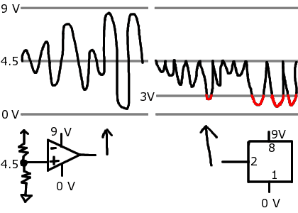

When pin 2 goes BELOW 1/3 of supply voltage the timing cycle starts when the unit is configured in monostable mode. When in this mode, the timer will time out and wait for the next pulse to start the timing cycle again. He has no negative power supply drawn. This means that we will have half wave rectified audio on pin 2 of the 555. Some op amps are not able to go 'rail to rail' so the voltage might not ever actually get down to zero volts. When there is no sound, the output of the 555 will be at its lowest possible value without figuring an offset. Most likely this will be below 1/3 supply voltage. He has a good start, but needs to work on a few things. He needs a little bit more processing on the front end before the 555. And for that matter, I'm not sure I would even use a 555. It depends on his answer to my original question of how the timer is supposed to function.

well what I'm wanting is for the noise above 100 Hz to trigger the timer so that it allows a pulse through for a preset amount of time hich will trigger the recorder. It really doesn't need to go for ten mintues I guess.
Hmmm. Not real descriptive. Do you want continuous noise to cause the recorder to continue to run? Or do you want the recorder to run for X time and then shut off until the noise stops and then starts for a new cycle?
Yeah so if you've set the timer for 10 minutes say.
Then once the noise starts it all off the recorder will record for ten minutes and then I guess regardless of whether the noise is still going the recorder will stop.
OK. So then if the noise stops for a couple of seconds and starts again the whole cycle starts over? Or do you want it to have to stop for more than a couple of seconds? You want some type of reset or literally a one shot with a manual reset?
Yeah I think one shot monostable with manual reset would just be fine.
So is this what I'd have then?
power supply connected to mic which is connected to a pre-amp, which is in turn connected to a high pass filter (is a passive filter alright??).
I don't particularly know what else would go between the high pass filter and the timer though because I don't quite get why you can't run an analog signal into the 555 timer.
And do I leave everything after the timer as is?
Well actually I can probably remove the wire connecting the tape recorder to ground because there is only one input there.
