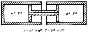

A closed composite system consists of two subsystems, A and B, which are connected by a movable piston allowing the exchange of particles [section 6.1]:
The only parameter is volume V = VA + VB (that's not the point here) and the number of particles is restricted by the equation n = nA + nB.
Assuming open systems are excluded by the 1st law, I see no justification to assign a property called "energy" to each of the subsystems, because both are open. I also have a problem saying "the composite (A+B) has a property called 'energy', so each subsystem also has such a property". I mean I also can't say: "(A+B) is divisible by 2, so A and B also have the property beeing divisible 2". Not beeing able to assign "energy" to open systems seems very weird to me, so what do I misunderstand here, using only the information given in the book and no previous knowledge from other sources?

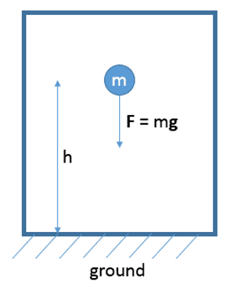

Consider the following mechanical system of a point mass in a constant gravitational field. According to my understanding of the definition of a well defined system (chapter 1 in the book) this system can also be regarded as a valid thermodynamic system. (Indeed, the authors use a point mass system in example 3.9, p. 37 to make clearer the concept of energy.) According to the authors' formulation of the 2nd law there must a stable equilibrium state according to the energy E = mgh (where I set the reference energy E0 to zero) this system currently has.
However, as the authors explain in section 4.3, in a mechanical system there is only one stable equilibrium state: the state of minimum energy (point mass on the ground with speed= 0). Doesn't this contradict their formulation of the 2nd law, because the system shown with E = mgh is obviously not in a stable equilibrium state: One can easily extract energy (mgh) from the point mass while the mass is falling.
