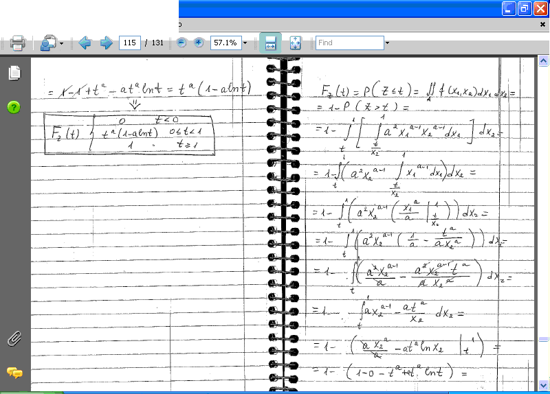

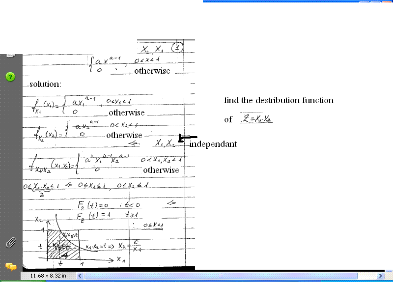

the question and solution
after i they find the total interval of the total function
i can't understand
what they do with the graph and how they derive the integrals from it
how to we know that x1x2<t is bellow this line
how to we know that x1x2>t is above this line
