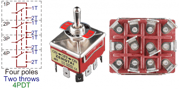

A single throw switch is a simple on/off switch with two terminals. A double throw switch has three terminals and can be wired for the shared terminal to either select one of the two inputs, or it can distribute a signal to one of the two loads.
The number of poles is the number of lines being switched. You say four.
You need a switch or relay that is described as 4PDT.
You could make that from a pair of 2PDT aka DPDT units.
Do you need a manual switch, or an electrical relay that must be powered while in one state, or a latching relay that holds it's last state selected without power?
Google '4PDT latching relay' and you will find a solution.

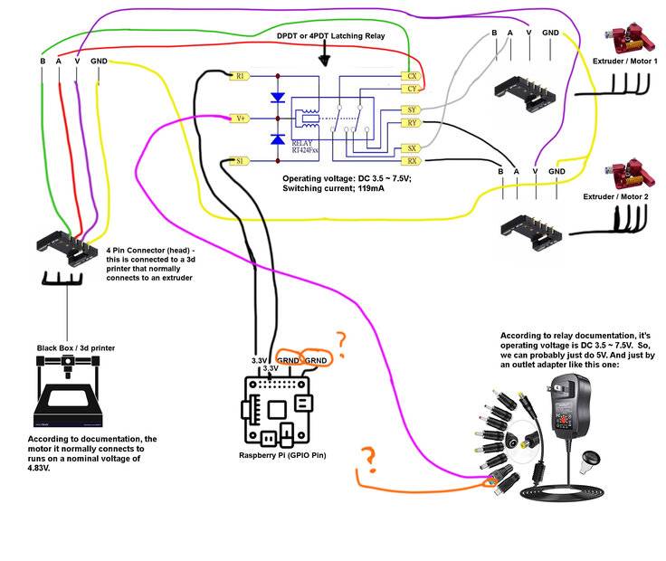

I spent the last couple of days (when I had free time) researching this, and made a potential wiring diagram of what I am trying to do (with possible connections), but there a few things that I am not sure about. Here is the diagram:
Circled in orange are the things that I am not sure about. Because for instance, what signal would I send to S or R, the inputs for this particular relay switch? As apparently both cannot be off for the relay to work (even if you send voltage).
Another issue that I am not sure about is voltage and ground connections - because in this case, I would have to use a splitter to connect the voltage pin from the main connector to both the voltage pins of the other connectors (the ones that go to separate motors). This is probably not ideal, and I am not sure if that would even work. Same goes for the ground connections.
So, that's basically what I have at the moment. Again, I am a newb, so there's a very good chance I am misunderstanding certain concepts here, and have created a monstrosity above. So any help or guidance would be appreciated.

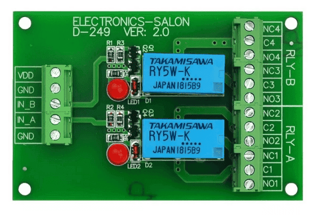

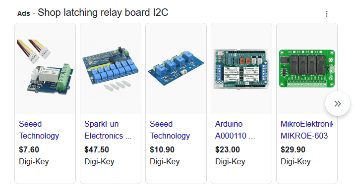

If you want to control this with a Pi, can you just find an off-the-shelf latching relay board that has some standard serial interface for the control signals (like I2C, which will be more commonly available for relay boards compared to WiFi)? Here are some examples:
https://www.google.com/search?client=firefox-b-1-d&q=latching+relay+board+I2C
I've used I2C controlled (non-latching) relay boards in production test fixtures, and they are simple to use and work well, IMO.
I'm a bit confused here. How would this help exactly? Maybe I misunderstood your comment about l2c being more commonly available than Wifi on relay boards).
But, I specifically want to use Wifi. I want to sit on my lazy bum, from my computer on third floor, press a button on my computer screen, it sends a signal to my router, the router talks to my PI, the PI talks to the relay switch, the relay switch -- switches the motors being used (and these motors, the PI, and the relay switch would be all located in the basement for example).
I have the WIFI already set up, it sends signals to the PI, the PI takes care of everything else - it can talk to a relay switch. The only thing I need now is for that relay switch to do the switching.
... Or did you mean standard relay board as a replacement for the DPDT relay?

The Pi does not have enough power in general on its GPIO signals to drive the relay directly. It is best to use a relay board that contains the relay drivers, and just control that relay board via some interface. I2C is a very common interface for this application, SPI is probably another one that is commonly used.

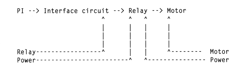

OK! It looks like we are (finally) all getting on the same page about what is needed.
This is a case of we have to work 'backwards' from the motor to the PI to figure out the details of what is needed.
  1. The motors already exist so the first thing to do is find a relay that can handle the motor voltage and current when the Motor starts, and then determine the protective circuit, if any, to protect the relay when the motor(s) shut off. So the Motor specifications will be needed.
  2. Next is to see if the chosen relay is available with a 12VDC coil (probably the easiest to interface to), or maybe a 5VDC coil. (3.3V relays are scarce, especially if the have to handle motor currents.)
  3. Then is the Relay Driver design; an interface circuit that can drive the relay coil. Also needed is protection for the Driver circuit when the relay coil shuts off.
  4. And now the task is to design the interface between the Relay Driver and the PI computer. Probably one or two transistors with a few resistors, or maybe an Integrated Circuit (IC, or Chip).
What is left is to choose a power source (12VDC?) for the relay(s).
You May want to add a few Pilot Lamps (LEDs?) so you can see what is energized and what isn't at any time. This make troubleshooting a lot easier both at the first time you turn it on and later when something stops working (besides they look cool :wink:).
I just checked the schematic in your post#8 above, (https://www.physicsforums.com/posts/6605635/) and what I describe here is the driver(s) to your 'R1' and 'S1' pins. It is unclear if the PI 4 pin breakout board can directly drive the motor(s). Are the 'B', 'A', 'V' pins designed to connect directly to the extruder motors, or are they GPIO (logic level) signals that the extruder expects and then the extruder drives the motors with its own power?
If the extruder powers the motor(s), then the block I labeled Motor Power would be the existing motor leads in the extruder.

Finally had some free time, so I updated the diagram/ schematic. Here is how it looks like now:
To clear up a few things, here are a few notes:
- I'm still not sure if a relay driver is even needed in this case. So this schematic does not include it.
- The 'B', 'A', 'V' (and GRND) pins are part of a jst jumper cable that comes attached to the 3d printer
(nothing to do with the PI pins). That jumper cable is usually attached to a single motor. What I want to do is relay that jumper cable, coming from the 3d printer, to a different (but same type) motor based on a signal.
- The relay's sole purpose is to relay those jst jumper pins ( 'B', 'A', 'V' (and GRND)) to another motor of the same type if it gets a signal from my PI. Both motors are 42-40 Stepper Motors
(more info here: https://creality3d.shop/products/creality-42-40-stepper-motor-with-round-shaft).
- Essentially within my diagram, the way I have wired it is that CX and CY correspond to B and A respectively. Then what I have is SY and RY connect to one motor, while SX and RX connect to the other. So when the relay switches, it connects CX to SX or RX AND connects CY to SY or RY.
Meaning that no matter what position the relay is in, one of the motors is receiving both channels (B and A) while the other one receives none of the inputs from the 3D printer.
- The PI is just sending logic level signals to S1 / R1, which are specifically only related to the relay itself (nothing to do with the motor or extruder). They are what tell the relay switch to either switch to S or R, which eventually correspond to either motor 1 or motor 2.
- The term of 'Extruder' is misleading. Common issue with human terminology is that it sucks. It really should say filament driver - since it drives the filament or 'ink' of a 3D printer using a motor that spins gears with teeth that grab onto the filament and push it into the hot-end of the 3d printer (but that's not important).
- The voltage to the relay could be supplied via an adapter to an outlet.
...(~phew). Okay. Still a few things to figure out though:
- The most crucial of which (in my opinion) is where/ how do I ground some of these components? For example, when you connect the PI's pins to the relay switches inputs (S and R), aren't they connecting to a coil which acts like an electromagnet to pull the switch latch? In which case, shouldn't these wires need to be grounded in order to complete the circuit and allow it to work?
- Is using a splitter wire okay/ correct for the voltage between the two motors? I basically want to reroute the voltage from the 3D printer jst jumper cable as well to either one motor or the other.
- The relay expects a 119mA current signal for switching. There is no way a PI pin can supply that. Looking at how my other beefy relay works, it looks like it uses some kind of an opto-isolator to basically be able to take in a few mAmps from the PI as signal to then drive the actual relay. The max current for any PI pin is around 3 mAmps (conservatively, but apparently can go up to 16). This is something I need more research into, but I'm guessing the relay drivers that were discussed previously have this capability?
Hope that answers some questions you guys had. And I know its a lot to take in / digest (definitely a lot for me haha), so take as much time as you need. Any help, as always, is appreciated and welcome.

I mean, does the diagram make sense?
Again, any help is welcome. Thank you again.

Wait, what? Did I miss the memo? You are wanting to reverse engineer the drive signals to your 3D printer without understanding how 3D printers are driven? Hopefully I'm misunderstanding your posts...
YES!
The various GND, GRND, signals (the ones with a "?"[/size]) should be connected together.
We have a better chance of deciding the need for a relay driver if you can tell us
the part number on:
1) that 'optoisolator' that drives
2) the 'other beefy relay'
3) 'relay you have chosen'
Cheers,
Tom
No, no. Haha. Geez, am I that bad at explaining my thoughts?
I am specifically NOT trying to do that. No reverse engineering - I want to leave that stuff alone. That's why instead of doing something like that, I just want to redirect whatever signals (and power) its sending through its 4 pin jst connector cable to somewhere else. It's basically a circuit relay/ rerouting circuitry. That's all.

YES!
The various GND, GRND, signals (the ones with a "?") should be connected together.
Which would make sense, but don't you have to worry about certain ground connections not being a sufficient enough grounding? Ie: if you have too high a current or voltage going through a system, you could potentially oversaturate the ground to the point where it stops being a ground, and then you end up frying everything.
An offshoot question (also from my previous post), is there any reason that using a splitter wire for the wire carrying the voltage (from the 3d printer) would not work? If I hook it up to two different motors, and only at most one is ever in use, could that still cause potential losses within the voltage being carried to one of those motors?

We seem to have an XY problem here. You're asking about problem Y (how to switch a set of signals) but you are likely to get better advice if you asked how to solve problem X - your top level problem, whatever that is. What is your top level objective? Are you trying to print with two filaments? Print two copies of an object with different extruders? Something else?
> From the diagram in #17 "the motor it normally connects to runs on a nominal voltage of 4.83 V."
Are you mixing up the DC voltage drop across the resistance of a stepper motor winding with the supply voltage used by its driver?
Well... it depends. For instance that can be a real problem if you are using a common Ground (or Common) wire for both low voltage signals, maybe from a sensor, and also for power to something that draws a high current, maybe a motor. The higher current that the motor draws can create a signal in the common Ground wire that is stronger than the signal from the sensor. Then whatever is trying to read the sensor ends up also reading the motor current. Oops!
In that case, separate Ground wires would be used. Except for a few special cases, all Grounds get connected together somewhere in the overall system. Just make sure that each wire is large enough for the total current it is expected to carry.
That is not a problem. There will be losses in a wire only when there is current flowing thru it.

No, look at that circuit, it's a mess. The wall wart doesn't belong there and there is no signal coming from the Pi.

That's not the relay board you want, pick one with a built in driver like this https://czh-labs.com/products/elect...version-for-arduino-raspberry-pi-8051-pic-495
  • Connect your 5V wall wart between VDD and GND (the GND adjacent to VDD; do NOT connect this to any other ground, the whole point of the opto-isolator is to isolate the relay from the Pi!) Make sure you get the polarity correct (check the wall wart with a multimeter and if it reads 5V and you have the leads plugged in correctly the wall wart wire on the red lead is VDD; if it reads -5V the black lead is VDD).
  • Connect IN_A to a GPIO pin.
  • Connnect the bottom GND to Pi GND.
  • Connect the A pin on the printer to C1 and the B pin to C2.
  • Connect the A pin on the first extruder to NC1 and the B pin to NC2.
  • Connect the A pin on the second extruder to NO1 and the B pin to NO2.
  • Connect all 3 V pins on the printer and the extruders together.
  • Connect all 3 GND pins on the printer and the extruders together.
  • Relay B is spare, don't connect anything to it.
Now when you send the GPIO pin LO (OFF) the first extruder will be connected to the signal from the printer and when you send it HI (ON) the second extruder will be connected. Note that depending on which GPIO pin you use (pull-up or pull-down) one or the other extruders will be connected on power up until your software switches the pin.
It's much easier when you show what the problem is and let us work out the solution. If you guess what you think the solution is we then have to guess what the problem is and nobody knows anything for sure!
(Note you could also use an I2C relay board like @berkeman suggested - the I2C is between the Pi and the relay driver, its got nothing to do with WiFi - but I couldn't find one with a DPDT relay).
I'm a little bit confused by this statement. I agree the circuit is messy, but there is a signal coming from the pi. It would be coming from the GPIO pins. Although, as you point out later, and now I am realizing it myself, there needs to be a relay driver of some kind that receives that signal instead, and then drives the actual relay accordingly (since those pins don't have enough power to do so by themselves).
