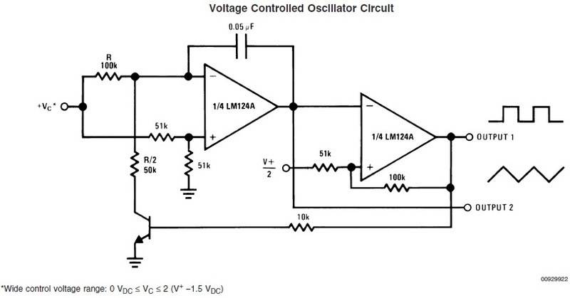

Way back when, I used Nationals LM324 Low Power Quad Op-amps for the VCOs (and bandpass filters) of a synthesizer. I made the VCOs using a single supply as in their datasheet.
Instead of trying to manipulate your VCOs output to do the scaling, have you considered altering your keyboard to give the "scaled voltages"? In my opinion this would much simpler and your VCOs good linearity can be realized.
