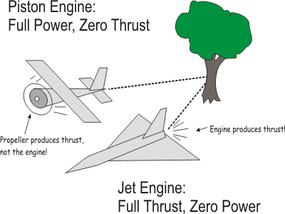

Say the throttle of the airplane in the drawing is at a certain level. Then double the throttle opening. For sure fuel consumption will be greater. For sure the force on the cable will be greater. For sure the airplane won't move. So where does the extra energy goes? I can assure you that the exhaut nozzle of the jet engine will become a much more effective hair dryer! The tree will loose his leaves more easily due to the air speed increase and it will burn up more easily from the extra heat.
Nope...the plane WILL move. The cable (modeled as a very stiff spring) will stretch a little more due to the increased throttle and the plane will move to the new location of the end of the cable. Steady state will be achieved and the plane will then remain at the new location. Triple the throttle opening and the cable will stretch even more, and the plane will move to the end ever more streched cable. And...the hair drier will dry hair more rapidly!
Again, it is irrelevant that the cable is a spring or not. If the airplane has an engine that produces 1000 N with a velocity of 100 m/s for the exhaust gas, it will burn half the fuel compare to the same airplane with an engine that produces 1000 N but with a velocity of 200 m/s for the exhaust gas. Still the spring would have the exact amount of stretch because it would be under 1000 N of force in both cases. Power is irrelevant once there is no displacement.

The amount of power you will put to maintain a force necessary for keeping the spring compression is only dependent of the machine's ability and efficiency to produce that force, whether the machine is a jet engine, a car or the human body. The most efficient "machine" will be the latch, as it requires no energy transfer to maintain the force needed.
Another example: Take a vehicle that is driving along the highway. You calculate the drag force times the vehicle speed and you get the power needed to maintain the vehicle motion. This is the minimum power that needs to be produced to keep the motion. If the vehicle has an electric motor it will produce just slightly more power than the minimum required (a little heat loss due to bearing friction, for example). If the car has an IC engine, the power produced will be a lot greater (Just think of the heat loss through the cooling and exhaust systems; plus the friction losses will be a lot greater due to the need for gear ratios to match the engine rpm to the wheel rpm). Note that when we say "losses", it is "lost" in the sense that it doesn't go where we want, but it still creates an effect, either move or heat something else. We often recuperate those losses for other means like using the cooling system of the IC engine to wam up the passenger compartment, something that an electric motor cannot do (more power will have to be created some other way).
Going back to the rockets-spring arrangement, what is the minimum power required to keep that motion? Answer: 0 W, since there is no motion. How much power will produce a machine to maintain the necessary force? It depends on the machine's ability to create that force.
But I'm not talking about two different plane engines with the same thrust. I'm talking about one plane engine operating at different thrusts. And while operating at different thrusts, it will consume different amounts of energy, and extend the cable by different amounts. Thanks for all the inputs.

From http://en.wikipedia.org/wiki/Thrust#Thrust_to_power":
