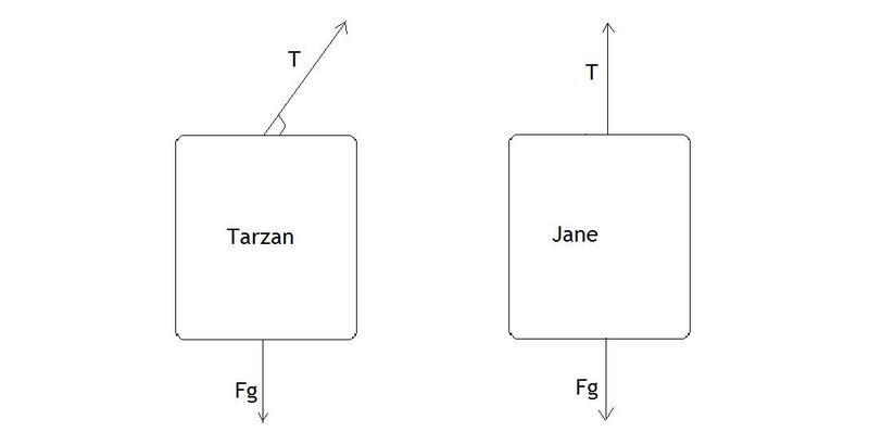

Here is the free body diagram .. yet it can not be used to find the acceleration if tension is not given

And back on-topic, Tarzan's weight (the mg vector down in the FBD) doesn't matter, since he is on a frictionless surface. All he does is add to the mass that Jane's weight accelerates. The tension in the vine pulls T horizontally to accelerate him. J's weight is what causes the force that accelerates them both as a coupled system.
Show us a combined drawing of them both, showing the tension force in the vine, J's weight vector, and the accelerating force on T. Use the equation for the sum of F = ma.

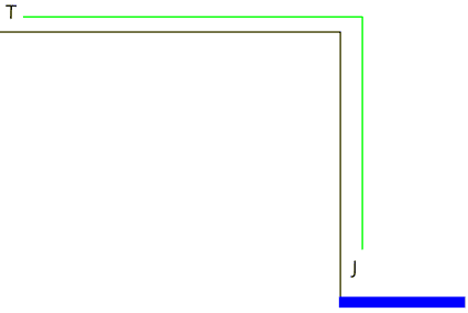

Note: the cliff edge is behind the river, and Jane is on the river. Look at the attached file. Remember what the question says "The vine runs horizontally to the edge of a cliff, then vertically where Jane (m=50kg) is hanging on,above a river filled with crocodiles"

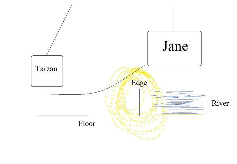

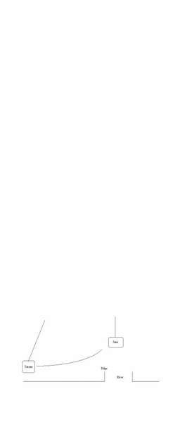

Shouldn't the overall diagram look like this?

For Diazona, I do not think your diagram is correct b/c vine by definition is a weak-stemmed plant that derives its support from climbing. Look back at the question >> A sudden sleet storm has removed all friction. Friction stands for air resistance.
It is important to read the question carefully before you answer it >> that goes for both of you.
There is no solution for this problem at the back of the text, however if its diagram is as easy as Diazona's, then it can be solved easily.

Diazona's diagram seems like a reasonable interpretation of this ambiguously presented problem. Why do you think friction stands for air resistance? Wouldn't you think that a sleet storm would coat the surface with ice, thus removing any friction that Tarzan could use to prevent his sliding towards the edge?
