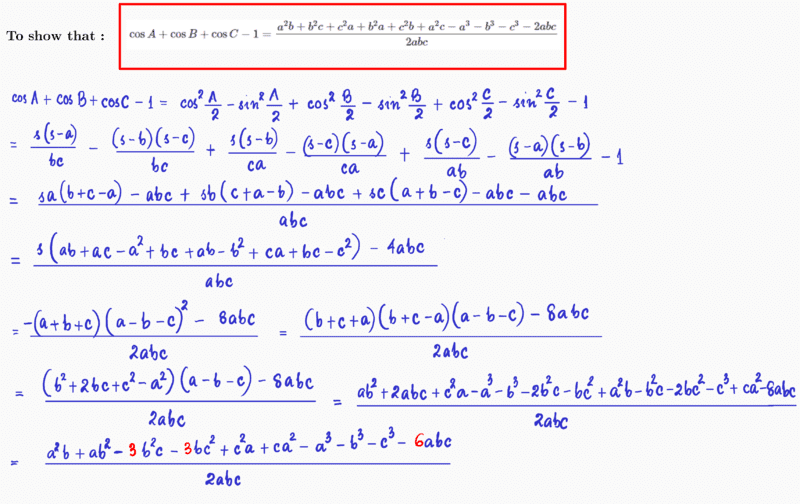

For a triangle ##\text{ABC}##, prove that $$\boxed{\cos A+\cos B+\cos C-1=\dfrac{a^2b+b^2c+c^2a+b^2a+c^2b+a^2c-a^3-b^3-c^3-2abc}{2abc}}$$
1. ##\cos\frac{A}{2}= \sqrt{\dfrac{s(s-a)}{bc}}## and its cyclic counterparts.
2. ##\sin\frac{A}{2}= \sqrt{\dfrac{(s-b)(s-c)}{bc}}## and its cyclic counterparts.
3. ##s=\dfrac{a+b+c}{2}##, the semi perimeter of a triangle.
Problem Statement : The statement appeared on a website where a different problem was being solved. I got stuck at the (first) statement in the solution that I posted above 👆. Here I copy and paste that statement from the website, which I cannot show :
Attempt : To save time typing, I write out and paste the solution using Xournal++, hoping am not violating anything.
Issue : As evidence by the coefficients that I have marked in red, my answer is not the same as that shown for the problem.
A hint as to where I went wrong would be welcome.

I cannot see what you have done in every step except the first one, so let's see.

I assume you made a sign error somewhere but I do not see exactly where since I cannot trace your calculation.

I was trying to save work, typing equations out. However, I will now type out the answer and remedy my mistake above.
To prove : For a triangle ABC, show that ##\boxed{\cos A+\cos B+\cos C-1=\dfrac{a^2b+b^2c+c^2a+b^2a+c^2b+a^2c-a^3-b^3-c^3-2abc}{2abc}}##.
Solution : Starting from the left hand side,
$$\begin{equation*}
\begin{aligned}
\cos A+\cos B+\cos C-1 & =\cos^2A/2-\sin^2 A/2+\cos^2B/2-\sin^2 B/2+\cos^2C/2-\sin^2 C/2-1\\
&=\frac{s(s-a)}{bc}-\frac{(s-b)(s-c)}{bc}+\frac{s(s-b)}{ca}-\frac{(s-c)(s-a)}{ca}+\frac{s(s-c)}{ab}-\frac{(s-a)(s-b)}{ab}-1\\
&=\frac{as(b+c-a)-abc+bs(c+a-b)-abc+cs(a+b-c)-abc-abc}{abc}\\
&=\frac{(a+b+c)(ab+ac-a^2)+(a+b+c)(bc+ab-b^2)+(a+b+c)(ac+ab-c^2)-8abc}{2abc}\\
\end{aligned}
\end{equation*}$$
The numerator simplifies to the required ##\mathcal{N} = -a^3-b^3-c^3+a^2b+ab^2+b^2c+bc^2+c^2a+ca^2-2abc##.
Thank you for your help.
I think you could have begun with the law of cosines: e.g. ## c^2=a^2+b^2-2ab \cos{C} ##, rather than a formula that most of us probably wouldn't ever memorize, or maybe even recognize. With a little algebra with the 3 cosines, the result follows very routinely.

Yes, thank you. I totally overlooked the law of cosines.
Attempt :
\begin{equation*}
\begin{aligned}
\cos A+\cos B+\cos C-1 & =\frac{b^2+c^2-a^2}{2bc}+\frac{c^2+a^2-b^2}{2ca}+\frac{a^2+b^2-c^2}{2ab}-1\\
&=\frac{a(b^2+c^2-a^2)+b(c^2+a^2-b^2)+c(a^2+b^2-c^2)-2abc}{2abc}\\
&=\boxed{\frac{a^2b+ab^2+b^2c+bc^2+c^2a+ca^2-a^3-b^3-c^3-2abc}{2abc}}\\
\end{aligned}
\end{equation*}
Thank you.
