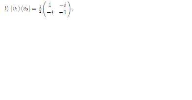

Hi, I wanted to know how to solve this question , its not a homework question i am really asking for , more the general way to solve these types of questions... I don't understand how it forms into another matrix. I have the answer attached as well , but could some one explain ? (I don't think the matrix A is needed , i just copied it as well )
Cheers for any help guys :)

Do you know what [itex]\langle v_2|[/itex] represents? It is the conjugate transpose of [itex]|v_2 \rangle[/itex]. So [itex]\langle v_2|=\frac{1}{\sqrt{2}}(-i,-1)[/itex].
Therefore
[tex] |v_1 \rangle \langle v_2|=\frac{1}{2} \binom{i}{1}(-i,-1)[/tex]

Almost, we are working with complex vectors here so it is the conjugate transpose. Do you know how to form a matrix from the the expression in my previous post?
To represent an operator as a matrix, you must choose a basis. In this case, the question presumably wants you to write it in the same basis that [tex]|v_1\rangle[/tex] and [tex]|v_2\rangle[/tex] are given in. You are given that
[tex]|v_1\rangle = \frac{1}{\sqrt{2}} ( i|1\rangle + |2\rangle)[/tex]
[tex]|v_2\rangle = \frac{1}{\sqrt{2}} (i|1\rangle -|2\rangle)[/tex]
The operator is
[tex]|v_1\rangle\langle v_2|[/tex].
The matrix elements of this operator in the basis [tex]|1\rangle, |2\rangle[/tex] are
[tex]A_{ij} = \langle i|v_1\rangle\langle v_2|j\rangle[/tex].
For example, the (1,1) element of the matrix will be
[tex]A_{11} = \langle 1|v_1\rangle\langle v_2|1\rangle = \langle 1|v_1\rangle \langle 1 | v_2 \rangle ^{*} = \frac{i}{\sqrt{2}}\frac{-i}{\sqrt{2}} = \frac{1}{2}[/tex].
Cheers Cyosis I understand that better now , but i still don't understand how what you wrote is i matrix and not a scalar ? , can u show me for a general case ? , or just show me how the answer is acheived ?
To calculate [itex]|v_1 \rangle \langle v_2|=\frac{1}{2} \binom{i}{1}(-i,-1)[/itex] just think of it as two matrices. You multiply the first row of v1 (i) with the first column of v2 (-i).
What you will get is this:
[tex]\frac{1}{2}\left( \begin{matrix} i*-i & i*-1 \\ 1*-i & 1*-1 \end{matrix}\right)= \frac{1}{2}\left( \begin{matrix} 1 & -i \\ -i & -1 \end{matrix}\right)[/tex]
