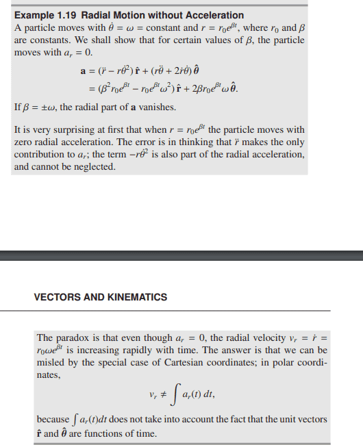

In the example above, the authors claim that when ##r=r_0e^{\beta t}##, the radial acceleration of the particle is 0. I don't quite understand it because they did not assume ##\beta=\pm \omega##.
Can anyone please explain it to me? Many thanks.
No, they do not make that claim. They claim that the radial acceleration is zero when ##\beta=\pm \omega##.
All you have to do is replace ##\beta## with ##\pm \omega## in the expression for a and you'll see that the coefficient of ##\hat{r}## vanishes.
I see, thanks.
