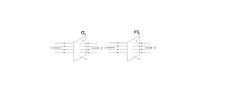

Two plates (area=s) charged to +q1 and +q2 (q2<q1)are brought closer to form a capacitor of capacitance C.The potential difference across the plates is
2. Homework Equations
##V##=##\frac{Q}{C}##
[/B]
I don't know how are these plates going to form a capacitor as both of them have same type of (i.e positive)charge and in order to form a capacitor two conducting plates with equal and opposite charges are required.

##\vec{E}##=##\frac{σ}{ε0}##=##\frac{Q}{ε0A}##
What if one would to consider two capacitors one charged with a q1 charge and the other with a q2 charge?
That's the idea, but check your formula for the electric field... a sheet of charge has two sides so you need to take that into account when you apply Gauss' Law to find the field.
edit: See for example: Hyperphysics: Electric Feild, Flat Sheets of Charge
Now, you have two sheets of charge with different charge densities...
Likes gracy

##E##=##\frac{σ}{2ε0}##
Right?
Right?
That will give you the field between the plates due to one plate with net charge density σ. You have two plates with different σ's. Draw a sketch and pay attention to the field directions. How do they sum?
Likes gracy
Electric field due to one plate having charge density σ1 in between the two plates(we will avoid electric field at other places)
##E_1##=##\frac{σ1}{2ε0}##
##E_2##=##\frac{σ2}{2ε0}##
gneill said:
How do they sum?
Vector addition of ##E_1## and ##E_2##
Okay, so assuming that you choose an appropriate direction for the net field, what's an expression for its magnitude?
Likes gracy
##\frac{σ1}{2ε0}##-##\frac{σ2}{2ε0}##
as Q1>Q2
Hence σ1>σ2
Good. But you can expand that a bit using the problem's given variables: s, q1, q2. Usually you want to express any results using the given parameters. You can pretty it up by factoring out the common variables.

##\frac{Q1}{2ε0s}##-##\frac{Q2}{2ε0s}##
Keep going...

gracy said:
But it is not mentioned that electric field is constant,is it?
The field from a relatively large sheet of charge is uniform. Here "relatively large" means that for the location of interest the distance from a face of the sheet is small compared to the size of the sheet, and it's not too close to the edges of the sheet where "edge effects" interfere with the uniformity.
Likes gracy
So I should consider electric field to be uniform in this case?
Yes, clearly. There are two parallel sheets of charge on plates forming a capacitor.

gneill said:
how do you find the potential difference between two locations?
Electric field multiplied by r?
Answer given in my book is
##\frac{q1-q2}{2C}##
Sure. You make it look like a guess though. It should be an expression that's given in your text and notes (although they're more likely to use "d" rather than "r").
That's fine. Once you've factored and grouped the variables for the potential difference expression you should be able to pick out the expression for capacitance in the mix and make the substitution.
Likes gracy
Ok.
##V##=##\frac{q1-q2}{2sε0}##d
But we know ##C##=##\frac{sε0}{d}##
Here s=A=Area
##\frac{d}{sε0}##=##\frac{1}{C}##
##V##=##\frac{q1-q2}{2C}##
Thanks @gneill.:smile:
