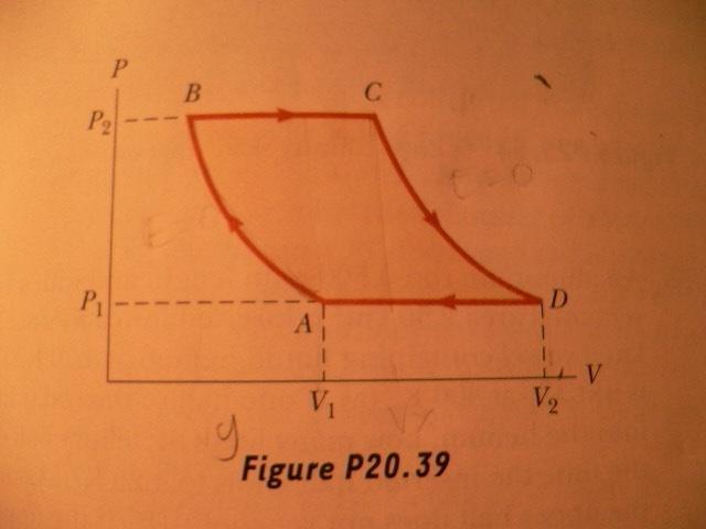

An ideal gas is carried through a thermodynamic cycle consisting of 2 isobaric and 2 isothermal processes.
Show that the nett work done is
W=P1( V2-V1)ln ( P2/P1)
i am really stuck at this qn for very long. Please help me
I assume that you mean you have been working on it for a long time! Show us what you think you do understand about the problem and what work you have already done.
i know that Work done by the gas is
nRTIn( Vf/Vi) and this is only for the two isothermal processes
Since BC and DA are isobaric, the 2 isothermal processes are AB and CD.
The nett work done is the shaded area in the diagram.
But i do not know the volume of the gas at B & D.
