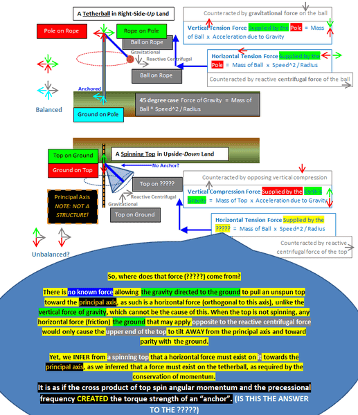

Diagram:
Diagram comparing a tetherball in right-side-up land with a spinning top in upside-down land, showing forces labelled Vertical Tension, Horizontal Tension, Gravitational, Reactive Centrifugal and Vertical Compression, with a callout asking where the horizontal force on the top comes from.
Text from the diagram:
____________
So, where does that force (?) come from?
There is no known force allowing the gravity directed to the ground to pull an unspun top toward the principal axis, as such is a horizontal force (orthogonal to this axis), unlike the vertical force of gravity, which cannot be the cause of this. When the top is not spinning, any horizontal force (friction) the ground that may apply opposite to the reactive centrifugal force would only cause the upper end of the top to tilt AWAY from the principal axis and toward parity with the ground.
Yet, we INFER from a spinning top that a horizontal force must exist on it towards the principal axis, as we inferred that a force must exist on the tetherball, as required by the conservation of momentum.
It is as if the cross product of top spin angular momentum and the precessional frequency CREATED the torque strength of an “anchor”. (IS THIS THE ANSWER TO THE ?)
____________
  • Diagram comparing a tetherball on a rope pole with a spinning top, showing vertical and horizontal force arrows, a dashed circular path, and a bottom panel of highlighted explanatory text.

"A spinning top in upside-down land" ... what does this mean? Gravity is up?
Looks like a top spinning in place, at an angle, and precessing.
The descriptions of both the tether ball and the top appear to be mixing up inertial and non-inertial representations. It's trying to use an analogy that does not quite apply since the top has an additional angular momentum term not present in the tether-ball.
Try repeating the analysis entirely in an inertial frame.
The physics of both tether balls and tops are well established - have you tried looking them up?Where did you get this graphic?

No. I am not trying to assert equivalence between the top and the tetherball. I actually am trying to disestablish the notion that the same arguments that apply to the functioning of a tetherball could somehow totally account for the behavior of a top, that somehow that all you need conservation of angular momentum, and that after you assume that, it all somehow handy-dandy, as if you identified the balance of forces required by Newton's law, as well as their origins. What I am saying in the diagram is that the balance of forces is easy to see for the case of the tetherball, but it is not easy to see in the case of the top. Conservation of momentum is insisted upon by the diagram, not doubted. Yet, as the diagram suggests, there does not seem to be an object outside the top that is actually providing the rotating force on the top toward alignment with the principal axis. The ground is not doing this and gravity is not doing this (and in fact gravity, together with the influence of the ground, only provides the rotating force on the top away from alignment with the principal axis), as explained in the bottom of the diagram:
Diagram comparing a tetherball in a right-side-up land with a spinning top in an upside-down land, labelling the forces on each and a text box asking where the horizontal force on the top comes from.

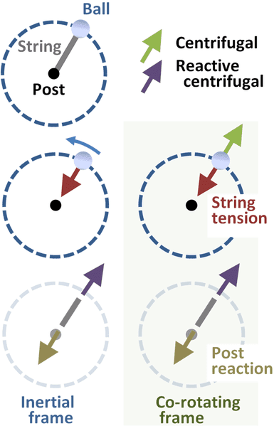

Both frames ARE inertial. The viewer in these examples is situated in the non-rotating ground frame. The inertial viewer either sees a non-inertially moving tetherball or a non-inertially moving top. None of these spinning motions are being evaluated from a spinning frame of reference.
The term "reactive centrifugal force" does not refer specifically to a spinning frame of reference. It has a definition which is applicable in inertial frames as well:
Reactive centifugal force
Fictitious centifugal force
Fictitious vs. reactive centifugal force
I hope that makes it clearer.[/color]
Diagram comparing a tetherball in the inertial frame and co-rotating frame: ball on string around a post, with string tension toward the post, centrifugal and reactive centrifugal arrows, and post reaction labeled.
http://en.wikipedia.org/wiki/File:Reactive_centrifugal_and_centrifugal_forces.PNG

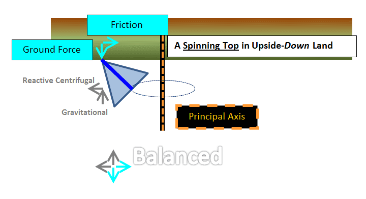

I found my mistake. I kept on putting principal axis at the location of the fulcrum, but that's not where it is actually supposed to be. Here is the corrected one, with the balance of forces revealed:
Diagram of a spinning top in an upside-down setting, with labels for Friction, Ground Force, Reactive Centrifugal, Gravitational and Principal Axis, and a Balanced force symbol.
I had thought you had found the graphic on the web someplace other than Physics Forums - I take it then, that this is your work?
The diagrams are unclear then - try tidying them up.
The way you have drawn them it looks, for example, like you intend the reactive centrifugal force to act on the body in curved motion. The free-body diagram for the ball shouldn't have it - it should only have tension and gravity. (Technically you have not drawn free body diagrams at all though so it is hard to see what you intend anyways.)
Your "corrected" diagram looks a little odd to me, you seem to be having the entire top moving in a circle - and you seem to have the reactive centrifugal force at the center of mass for the top (the body doing the circular motion) - compare real life example:
http://www.youtube.com/watch?v=03k9CgvL_dQ&feature=related
... the contact point sits still and the com precesses much like your first diagram appears to be showing: axis through the point.
I don't see any torques or angular momenta in your diagram - which would seem to be needed if you really want to show what else, besides conservation of angular momentum, is needed to identify and locate all the forces.

The axis is not exactly through the point. However, it is asymptotically close to it.
When the axis is exactly at the point of the fulcrum, then the torque due to gravity has been avoided as the top would be directly spinning vertically.

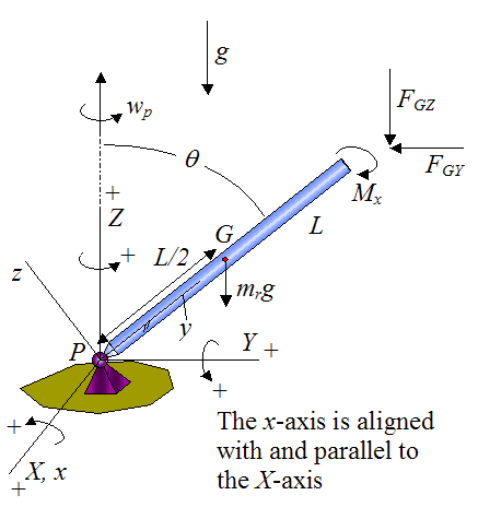

Diagram of a rod pivoted at point P on a surface, tilted at angle theta from the vertical Z axis, with length L, centre of mass G at L/2, gravity g acting down, weight m_r g at G, forces F_GY and F_GZ and moment M_x at the free end, and axes x, y, z, X, Y, Z labelled.
Note that point P is treated as a frictionless pivot. Therefore it exerts no moment (torque) on the rod.
If we treat the top and the ground as an isolated system, then we can assume that there is no net force on the Earth and the top. The Earth must produce a force equal and opposite to the top so that the center of mass can remain fixed with respect to the initial center of mass frame, and that is a very important requirement to obey the law of conservation of momentum.
The wrong thing to do was to assume that a top precessing at an angle can have its principal axis going exactly though its fulcrum.

I believe this is your key mistake. First of all, there's no need for sideways friction-- the top would work fine on ice, though it would precess so as to keep its center of mass in the same place, so the fulcrum would go in a circle. There is no need for any horizontal forces, the basic reasons for precession are the same-- which is that the point gravity acts (the center of mass) is not directly above the point where the upward force from the ground acts (the fulcrum), and so we have torque and a rate of change of angular momentum. If you want to keep the fulcrum in place, you do need a sideways force from the ground, and that will be a net force (unbalanced) on the system. You can, if you insist, use the awkward notion of a "reactive centrifugal force", but this is not a real force it is a fictitious force similar to using a noninertial reference frame.
There is a ficitious component to it and a non-fictitious component to the reactive centrifugal force. The non-fictitious component is what remains when we choose an inertial frame, which is the entire strategy I have used in my diagram, as no non-inertial frame has been chosen for any observers.
The diagram I showed from wiki, which illustrates both cases, proves my point:
