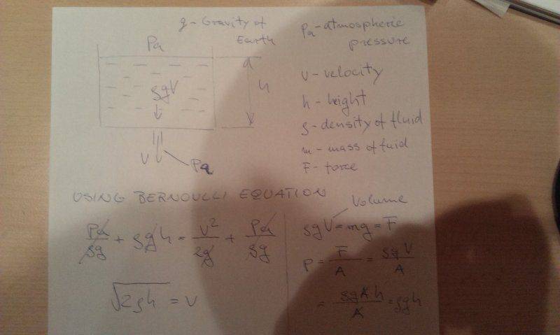

I think you are making a wrong conclusion. It causes no different effect than a hole without it, therefore there is no difference between a hole and a vectoring tube. Consider, if you put a hole on the side near the bottom then you clearly get thrust. Therefore a hole on the side is the same as a short straight vectoring tube on the side, both cause thrust to the side. Placing it on the bottom doesn't change any of that.Danger said:Simple, a short straight down tube is not a vectoring device. Its existence is totally irrelevant because it causes no different effect than a hole without it.
The water on the bottom of a bucket is also pressurized and the water reaction mass is also forceably ejected. The water rocket simply increases the pressure to make the effect obvious, but the water at the bottom of a bucket is already inherently pressurized by the weight of the water above it.Danger said:Do you not understand the irony of linking to the example of a water rocket? That is a pressurized system where the water reaction mass is forceable eject by an action against the interior or the bottle.
