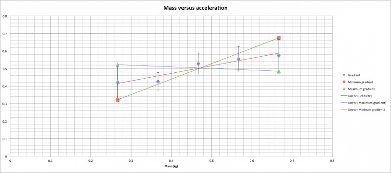

After collecting data for the classic physics experiment - motion down an inclined plane, I assembled my graph, and found something startling; in my graph, acceleration is proportional to mass (use the attached file for reference).
Theoretically, my graph should resemble the inverse, by a ∝ 1/m.
Can anyone explain possible reasons for this?
The experiment was running a margarine container down a wooden slope, varying the mass of the margarine container by adding brass weights each time.
What makes you think so?
F=ma, therefore a=F/m, which implies as the mass increases, acceleration decreases.
What is F in your case?
F=mg(sinθ-cosθ)
where θ is the angle of the inclined plane.
This is the net force of the block down the plane.
And inserting this into your expression for the acceleration gives?
Edit: you are also missing a friction coefficient...
