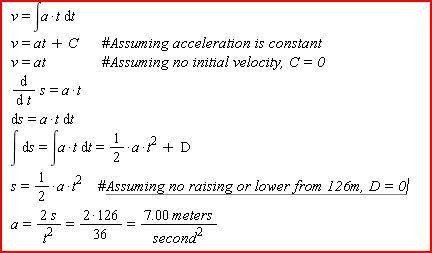

Justhelp,
This is a differential equation problem. If the acceleration is constant, then there are cut and dried formulas that can be used. The attachment shows how differential methods are employed. The final velocity is 42 meters/second and the average velocity is 21 meters/second.
Ratch
