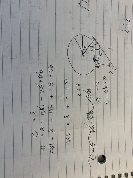

I have a biochem degree and have first year calc, linear algebra, and the pre-reqs for those (high school algebra and trig). I have to confess it's been a very long time since I've looked at that stuff and I'm having to refresh on the topic. I've found Khan Academy to be an excellent resource although I'm still getting tripped up by trig in relation to circles and angles

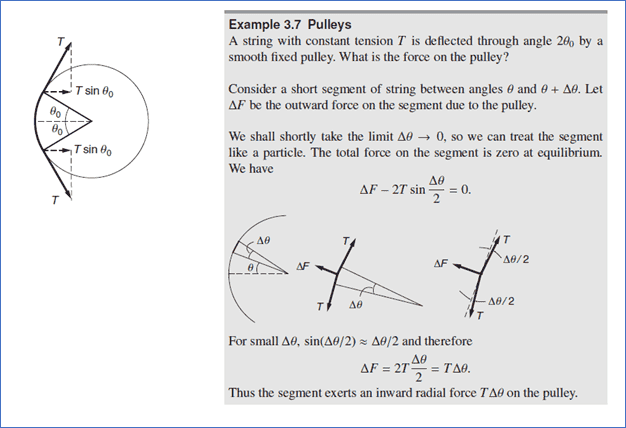

For example, in order to find the force on the pulley in the attached problem, one needs to find the horizontal component of T which is T * sin(angle at the top corner).
I don't get why that top corner angle is theta
  • Textbook diagram of a string with tension T wrapped over a fixed circular pulley through angle 2θ0, with a small segment between θ and θ+Δθ, and labels T sin θ0 and T sin θ0 on the horizontal components.
This is a good example of needing a strong trig and geometry background. If you extend the dashed line (labeled ##T \sin \theta_0##) you see it is parallel to the circle diameter; then the alternate interior angle is also ##\theta_0##. The tangent is perpendicular to the radius; and the sum of the triangle's angles is 180 degrees.
If you do enough of these problems, the angles should start to become obvious, then you can spend time on the actual problem and less on the underlying geometry. I certainly understand the issue - it can be very frustrating to struggle with a minor point (what is this angle?).
