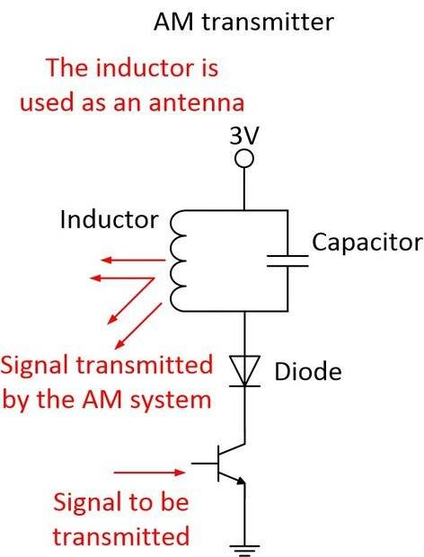

Just to share some information I found that gave me some light about the purpose of the diode:
https://www.edn.com/increase-piezoelectric-transducer-acoustic-output-with-a-simple-circuit/
This is for an acoustic transducer, but might be the reason the Elenco engineers included the diode.
And I found a printed Snap Circuits manual that mentions that the music IC provides the modulated audio signal in the system (I don't post the exact text here since I don't want to violate any copyrights law).
  • #33
When a red LED is used for that diode, it sheds even more light on how a significantly greater voltage compliance can be available for ringing the LC tank. With an LED the 3V power supply also seems more appropriate.
  • #34
topito2 said:
Summary:: AM transmitter
Hi, guys! Could anyone provide an explanation about how the following AM transmitter works? It is similar to the AM transmitter for project 122 of the Snap Circuit kit by Elenco. Does it work as a switching modulator?
The diode serves no useful purpose and looks to be in backwards, but no polarity of voltage is shown. There is little current limiting in the circuit, so the transistor may fail from excess current, except that the transistor has no bias. The inductor is a very poor antenna. How does it work? Poorly if at all.
Turn it around and this transmitter will have an output cleaner than any other in existence. 😉
  • Haha
  • #36
Both the diode and the transistor will be forward biassed and will operate with the +3V supply. The LED, (as shown in the video), illuminates when there is sufficient audio input. The LED is forward biassed, so it gives a couple of volts compliance for the oscillation of both phases. Build it and take a look, or simulate it and you will see.
The transistor bias current is limited by the audio source provided in the kit. The LED and the +3V supply in the kit limit the collector current. It is the half wave bias that generates the AM signal.
Yes, but it is more than sufficient to demonstrate the AM modulation on an AM receiver where only 10 uV of antenna input is needed.
If it worked any better it would need more than a "very low" EIRP class license.
