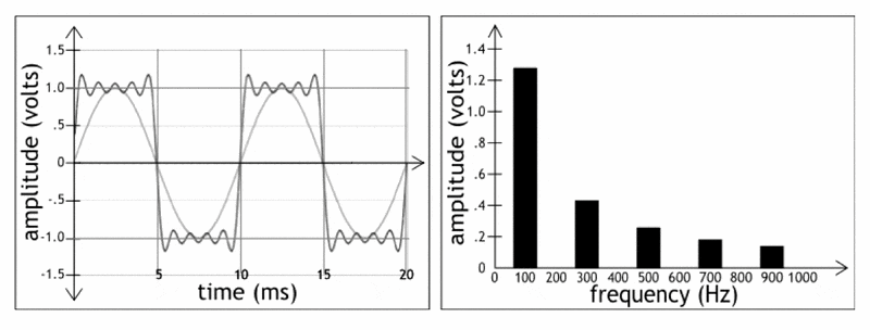

OldWorldBlues said:
What exactly is a harmonic?
https://en.wikipedia.org/wiki/Harmonic
A square wave is composed of a sine wave at the fundamental frequency (Fo = 1MHz in your case), plus odd harmonics of smaller and smaller amplitudes (3rd harmonic, 5th harmonic, etc...)
http://recordingology.com/wp-content/uploads/2013/05/Distortion_SquareWave_5Harmonics.gif
berkeman said:
Sort of. You need at least two impedances to form a filter divider. You can use an LC combination or an RC combination to form a lowpass filter...
https://upload.wikimedia.org/wikipe...svg/250px-1st_Order_Lowpass_Filter_RC.svg.png
Hmmm. So I don't know what the resistor is for, but it looks like the capacitor charges like a shock absorber, to level out voltage swings? And maybe the resistor is supposed to cancel out the capacitor's discharge when the AC wave flows backwards?
I see you have another thread asking about voltage dividers, so just think about that RC filter as a voltage divider. The impedance of the capacitor gets smaller and smaller at higher frequencies, so only the low frequency voltages make it through to Vout. The high frequency voltages are "shorted out" by the low impedance of the capacitor in that voltage divider.
