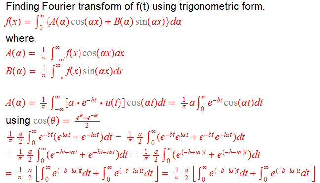

I have been trying to trace an error in my result without any success. I was trying to compare the application of two different forms of Fourier transform formulae.

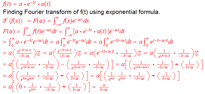

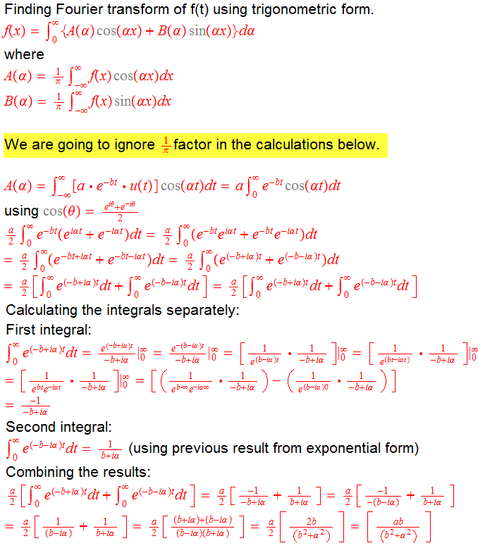

Hi,
I tried to apply different forms of Fourier transform, exponential and trigonometric forms, to the same function, f(t)=a⋅e^-(bt)⋅u(t). The result reached using exponential form is correct.
Please notice that while appling the trigonometric form of Fourier transform, the factor of 1/π was ignored.

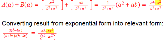

At the very end, the difference lies between "+a²" and "-ia²". I believe that I should have gotten "-ia²" instead of +a²" for A(α)+B(α) result. The error might be somewhere in the calculation for B(α), or the reason might be ignoring the factor of 1/π.
Could you please help me with tracing down that error? Thank you!

Before going through your calculations in detail, I'll note one thing about the sinusoidal vs complex Fourier representations. The exponential version is defined for both positive and negative frequency. If you are transforming a real signal, then the transform has conjugate symmetry: ##F(-\omega) = F^*(\omega)##. The inverse transform combines both positive and negative frequencies to get back a real signal.
The trigonometric version is defined only in terms of positive frequencies. The inverse transform sums only over positive frequencies. Everything is kept real. The two transformed functions are each real, and they contain in some sense the same information as the complex Fourier transform.
Something like that may be at the heart of what you're seeing.
OK, now I'll go through the analysis. One question, what is ##u(t)##? Looks like it may be a unit step, equal to 1 for ##t \geq 0## and 0 for ##t < 0##?
Likes PainterGuy

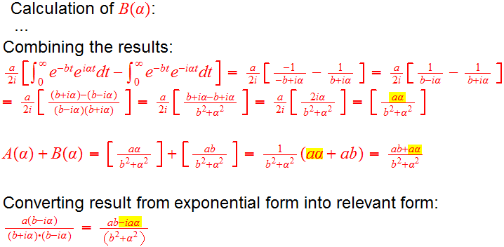

Actually before looking at your specific results, I'll look at the general transforms and show how they're related. I will also ignore factors of ##1/\pi##, etc so whatever I say will be off by some multiplicative constant.
I will use these identities:
$$\cos(x) = \frac {e^{ix}+e^{-ix}} {2} \\
\sin(x) = \frac {e^{ix}-e^{-ix}} {2i} $$
So
$$A(\alpha) = \int_{-\infty}^{\infty} f(x) \cos(\alpha x) dx \\
= \frac{1}{2}\left [\int_{-\infty}^{\infty}f(x)e^{i\alpha x}dx + \int_{-\infty}^{\infty}f(x)e^{-i\alpha x}dx \right ] \\
= \frac{1}{2} \left [ F(-\alpha) + F(\alpha) \right ]$$
And similarly
$$B(\alpha) = \int_{-\infty}^{\infty} f(x) \sin(\alpha x) dx \\
= \frac{1}{2i}\left [\int_{-\infty}^{\infty}f(x)e^{i\alpha x}dx - \int_{-\infty}^{\infty}f(x)e^{-i\alpha x}dx \right ] \\
= \frac{1}{2i} \left [ F(-\alpha) - F(\alpha) \right ]$$
This is the relationship you should expect (up to the constants I ignored) between the two types of transform.
Likes PainterGuy
So let's check. You have ##F(\alpha) = \frac {\alpha} {b + i\alpha}##. So that gives ##F(-\alpha) + F(\alpha)## = ##\left ( \frac {-\alpha} {b - i\alpha} \right ) + \left ( \frac {\alpha} {b + i\alpha} \right )## = ##\frac {-\alpha(b + i\alpha) + \alpha(b - i\alpha)} {b^2 + \alpha^2}## = ##\frac {-\alpha b -i \alpha^2 + \alpha b - i\alpha^2}{b^2 + \alpha^2}## = ##\frac {-2i\alpha^2} {b^2 + \alpha^2}##
Hmm. I see a problem already. This should be real and it's not. And that's because the expression for ##F(-\alpha)## is not the conjugate of the expression for ##F(\alpha)## as it should be. So I'll need to go through your complex integral in more detail to understand what's going on.

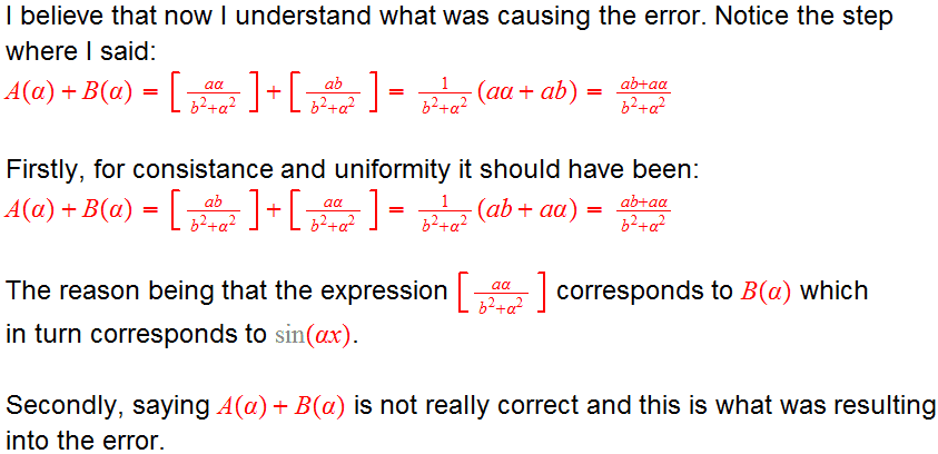

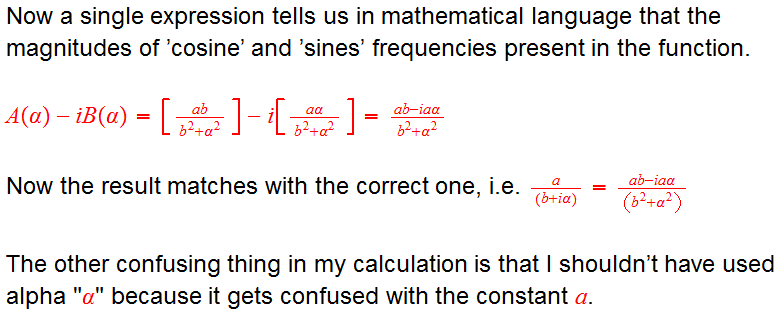

Hi,
First of all, I just realized that there was some errors in my calculations from post #1; the main error occurred in calculation of B(α) where I had mistaken letter "a" for alpha "α" and hence ended with α². The same thing happened at the very end where I said "Converting result from exponential form into relevant form".
I have fixed the errors below.
246693
Now let's rephrase the question.
You can see that the difference lies between "aα" and "-iaα". I believe that I should have gotten "-iaα" instead of +aα" for A(α)+B(α) result. The difference is also shown below.
246694
Now moving on to trace the error and fix it.
246695
246696
246697
@AVBs2Systems, thank you for your attempt to help me. I didn't follow your post closely but intend to do it later. First, I wanted to trace the error.
