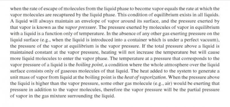

This topic has long fallen into disuse with me, so I sought confirmation on google---see excerpt below, from Fundamentals of Food Process Engineering, by Romeo T Toledo. In particular, note his final sentence.
