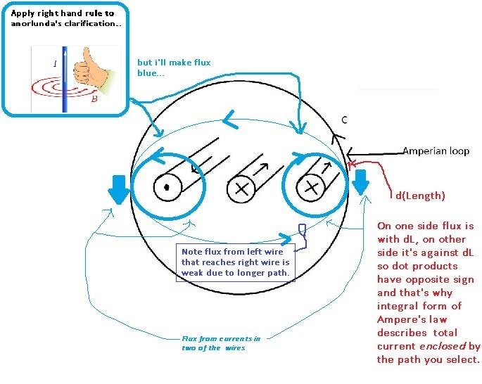

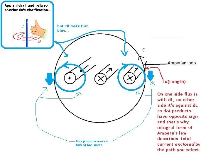

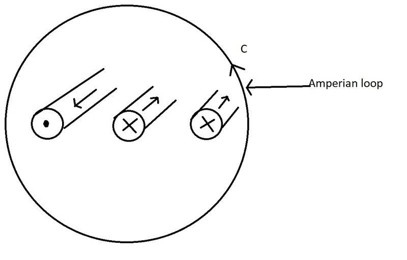

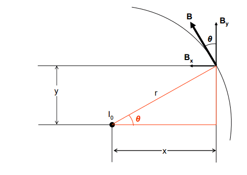

I am a little confused when I try to use Ampere's law to calculate the B field from a balanced three-phase system.
Consider the following, shown in the picture below:
Lets say I want to calculate the value of B at a distance r (radius of my Amperian loop), the value of r is big enough so that the loop encircles all three conductors.
From Ampere's law we have:
[itex]\oint_{c}\vec{B}\cdot d\vec{l} = \mu\times I_{enclosed}[/itex]
However, since the sum of the three currents = 0, i.e. net current out of the surface encircled by the curve C is equal to 0, indicates that the value of B at point r is also 0.
So what am I doing wrong, how should I apply Ampere's law to get the correct result?

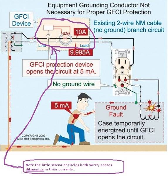

Ampere's Law Rules !
If you place a clamp-around ammeter around those three conductors it will indeed indicate zero , for the reason Charles Link stated.
Same is true for a single phase two wire circuit where you encircle the supply and return conductors.
That's how the GFCI fault detector receptacles that ought to be in in your kitchen and bathroom work.
http://www.ecmweb.com/basics/how-gfcis-work
Now there might be some B at individual points out there but integrating B around a loop will get you zero, or I enclosed.
For B at an individual point try a Biot-Savart calculation to each conductor ?

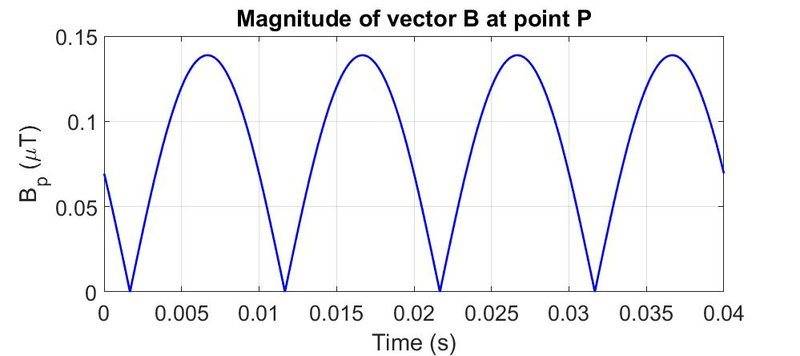

Thanks for the replies. I looked at a table which showed typical values of B at a distance x from a 420 kV transmission line, and they were not zero. So if I would want to calculate the value of B below the transmission line at ground level, I would have to use Biot-Savart equation on each conductor and sum them up?

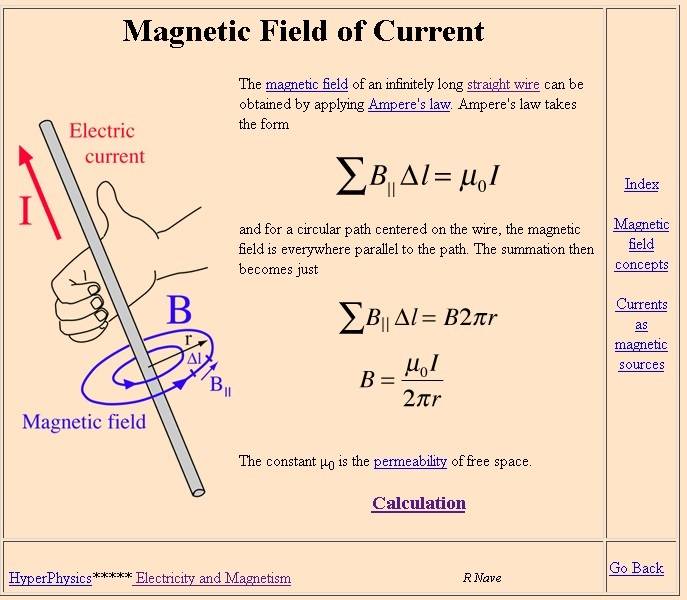

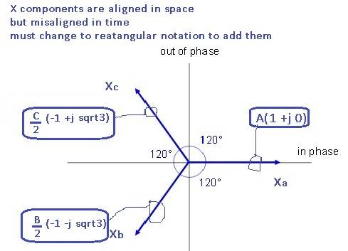

perhaps you should try this Ampere's law for each individual conductor and add them , considering geometry of the wires and observer?
from hyperphysics http://hyperphysics.phy-astr.gsu.edu/hbase/magnetic/magcur.html#c3
The farther from the wires you get the more nearly the individual fields will cancel , as the difference in their r's becomes insignificant.

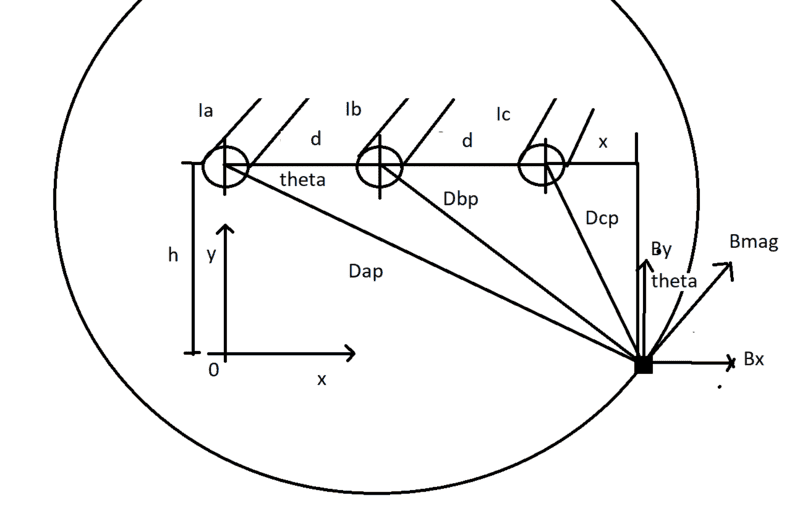

I found this tutorial from a UK utility . It's well written and straightforward.
http://www.emfs.info/wp-content/uploads/2014/07/Howtocalculatethemagneticfieldfromathree.pdf
and that's their approach.

The table is in a compendium written in Norwegian by a professor at the Norwegian university of science and technology, and his source is the Norwegian radiation protection authority, this one is also in Norwegian.
From the source in norwegian, they consider a value of 0.4 μT to be the safe limit for long term exposure. On page 5 they state that for a 420 kV line you would in some cases need to be 80-100 meters away from the transmission line for the value of B to be 0.4 μT or less.
Source (in norwegian): http://www.nrpa.no/publikasjon/bolig-naer-hoeyspenningsanlegg.pdf
Another source in english (http://www.who.int/peh-emf/project/mapnatreps/nznrl_emfbooklet2008.pdf) on page 6, states that the magnetic field 40 meters from a high voltage transmission line to be around 0.1-1 μT

Thanks Jim, and after reading the pdf you linked in post #6, it became clear.
First we consider one conductor and calculate the value of B at point P, then we consider the other two conductors individually and add the values of B from the three conductors to get the value of B at point P.

OliskaP said:
So without knowing about thetable, I would apply Ampere's law as shown in the picture from post #1, and concluded that the value of B to be zero for every point in space that lies on the Amperian loop.

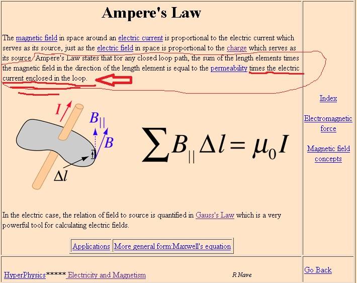

Ampere's law describes a close loop path. That's what the little circle in the middle of the integral sign is for. Note in that first picture you take the dot product around the path so answer is a scalar.http://hyperphysics.phy-astr.gsu.edu/hbase/magnetic/amplaw.html
If that loop encloses some current there'll be a field surrounding it.
So i think the short answer to your question is you have to pick your loop carefully so that it encloses the current of interest. A better answer is this
once we pick the path to enclose nonzero current we'll get nonzero flux for the conductor that we encircled ! .

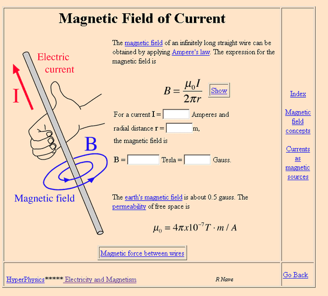

More subtle is this - observe second equation is not a summation or an integration, but the result of one.
It gives you the magnitude of flux at any point on the closed loop path. That path is a circle of radius r.
You'll have to ascribe to that flux a direction, along the path of that circle, in order to make it into a vector..
Biot-Savart does that for you, its multiplication is a vector cross product. In my youth i loved to work vector cross products, nowadays i seem to just talk about them. Cross product gives you a vector, dot product just a scalar..

dictates you sum the fluxes at every point around the Amperian loop . But you're not interested in the total of all the points, just one of them.
Flux at a single point is given by the second form , but only its magnitude since it's a scalar.
Standing under your power lines the magnetic field from each wire will have a direction too, along the circular path.
At any point below your power lines , you are not equidistant from all three wires. So which I and r will you use ? You have to use all of them and superposition,
calculate each break it into X and Y components then add , like in that tutorial .

@jim hardy If you want to make the observation point on the right side of the diagram where the two circles intersect, you need to have the blue circle on the left be a much larger radius, intersecting these two circles at the observation point on the right where the other two circles intersect. Just a simple input that might help clarify it considerably.
Charles Link said:
If the question was presented as a very introductory physics problem, the answer would be, in a very simplified (and really not completely correct) form, equal to zero. In this case the focus would be on applying trigonometric identities and/or a vector phasor diagram to show the answer is zero. \\ When considering actual power lines in the real world that supply 3-phase power, there is even the question whether it is on large high voltage/high current lines that are part of a power grid, or if it is simply the power supplied as 3-phase power to a large household appliance.
The reason i digressed was Oliska said this, suggesting more than a simple question.
Can one infer from the closed loop integral form that flux everywhere along the path is zero ? I think not. That was Oliska's trouble i think.
That equation was presented to me in school as H dot dl not B dot dl , and as an analogy to Gauss's law for Efields
It was easier for me to visualize summing the MMF dot dl's than the Flux dot dl's because i was envisioning something familiar - a clamp on ammeter. I actually played with one in lab - when you open the jaws you add reluctance so the reading drops . When you encircle all the wires the reading drops.
as i said, i plod.
old jim
Good thinking. Done.
Note they don't cancel locally, just when integrated over the whole path.
So flux at any point along the amperian loop is the sum of its parts, and not necessarily zero.

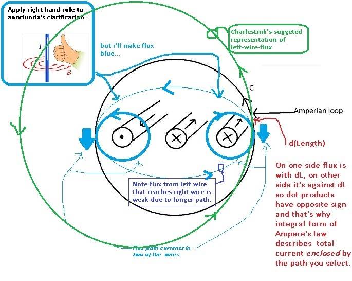

@Charles Link - Did i get it right ? Is this what you had in mind ?
I could have extended left flux's path way outside the amperian loop - it's a field after all not a discrete line..
Thanks for the suggestion

@jim hardy Not quite. The small blue circle on the left needs to be about 4x bigger. ## \\ ## Meanwhile, the algebraic analysis is somewhat simple in that the cosine function will take care of any + and - signs=direction of the current. For the observation point on the right, if the three circles have the same radius,(conductors would have to be very close to each other), we would have ## B=B_o [ \cos(\omega t)+\cos(\omega t+\pi/3)+\cos(\omega t+2 \pi/3)]=0 ##. ( ## \pi/3=120 ## degrees. ## 2\pi/3=240 ## degrees.) ## \\ ## If the radii are different, then we need to write ## B=B_1 \cos(\omega t)+B_2 \cos(\omega t+\pi/3)+B_3 \cos(\omega t +2 \pi/3) ## where ## B_1 ##, ## B_2 ## , and ## B_3 ## are each found by Ampere's law using the radii of the 3 circles in the diagram. This expression can be readily computed, once ## B_1 ## , ## B_2 ## and ## B_3 ## are known, and it will be of the form ## B=B_{total}=B_{to} \cos(\omega t+\phi ) ## for some ## B_{to} ## and ## \phi ##. ## B_{to} ## will not be equal to zero if ## B_1 ##, ## B_2 ## and ## B_3 ## are not all equal.
Okay, and i'll make it green .
How's this?
it's getting pretty cluttered - i won't try to draw the radii...
I feel a lot better now about our explanation.
How's this?
Thanks to all who contributed - it's what we do here, share our strengths and work on our weaknesses. In human affairs the whole is a little bit greater than the sum of its parts, isn't it?
old jim
@jim hardy The green circle is what I was looking for. Very good. Thanks. :) :) ## \\ ## And for each of these 3 circles with radius ## R_i ##, we have Ampere's law which gives ## B_i \, (2 \pi \, R_i)=\mu_o I ##, so we see that ## B_i =\mu_o I/(2 \pi R_i ) ## is different for each.

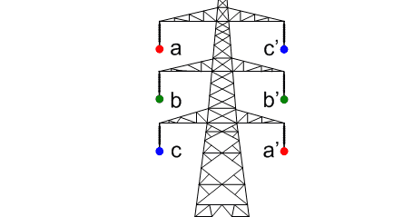

Good job guys.Now, the picture shows the setup for a double circuit transmission tower. Two three phase circuits. If I present it as a fact that the capacity is less than twice the capacity of one circuit (and staying with the thoughts of this thread) what does that tell you?
@anorlunda Very good. If I interpret what you are saying correctly: Are you saying that the magnetic fields from one wire cause magnetic fields at the other wires (cables), so that it is impossible to run as much current down each phase of a 3-phase system as you can down a single wire of single phase system without getting power losses caused by these magnetic fields? ## \\ ## Editing: Looking at the diagram and description more closely, I see it is a dual 3-phase system. Thereby, it is more complicated than a single 3-phase system, but basically the magnetic fields from the two different systems will interfere with each other, so you can't get twice the power through this system that you can from a single 3-phase system.
Thanks again.
I played around a little, and tried to calculate the magnitude of the resultant [itex]\vec{B}[/itex] at point P and got the figure below.
What do you guys think, looks reasonable? I might have done some errors, I did this in a rush. The interesting point is that the magnitude of B is zero some times.
Here is my schematic showing the different lengths etc. I used however 100 m as height h and x = 100 m as the distance between the right conductor and the observation point.
Other information:
Balanced three phase system, Irms = 1000 A, conductor diameter = 144 mm, distance d between conductors = 6 m.

OliskaP said:
Thanks again.
What do you guys think, looks reasonable? I might have done some errors, I did this in a rush. The interesting point is that the magnitude of B is zero at time = 0.005s.
https://www.physicsforums.com/attachments/210145Here is my schematic showing the different lengths etc. I used however 100 m as height h and x = 100 m as the distance between the right conductor and the observation point.
Other information:
View attachment 210148CODE USED TO GENERATE FIGURE 1 BASED ON FIGURE 2:

@OliskaP If you see my post #19, the result is a sinusoidal signal. By taking the amplitude, you changed the sign of the term when it goes negative. Otherwise it looks to be correct.
Good try but not quite. A three phase circuit carries 3x the power of a two wire single phase circuit. I'm asking you to compare one three phase circuit (3 wires) with double circuit (6 wires) on the same tower.
@anorlunda I just spotted my mistake also. See my edited post #23 above.
Yes. Now you got it. The fields of the two three phase circuits must interact with each other. If the external B field was zero, as in the OP, they wouldn't.
Edit: IMO that's another example of applying common sense alongside so-called absolute truths like Amperes law.
I'd have never thought about that. Voltage drop along a line is small so i see how coupling could have a surprising effect.
Ahh, big machines are just full of surprises.
old jim
old jim
In this case, (@anorlunda and @jim hardy please correct me if I'm wrong), I believe it is actually the change in magnetic field over time (by being sinusoidal at 60 Hz) that generates a Faraday E.M.F., ## \mathcal{E}=-d \Phi_m/dt ##, that is responsible for much of the power loss. The current that travels through this E.M.F. experiences a power loss which is essentially ## P=\mathcal{E} I ##. ## \\ ## (And perhaps it is slightly more complicated than this, because this would tend to indicate that sometimes a stray ## \mathcal{E} ## could be beneficial. A complete analysis might involve transmission line (wave) equations, and that would be kind of digressing off topic.)
