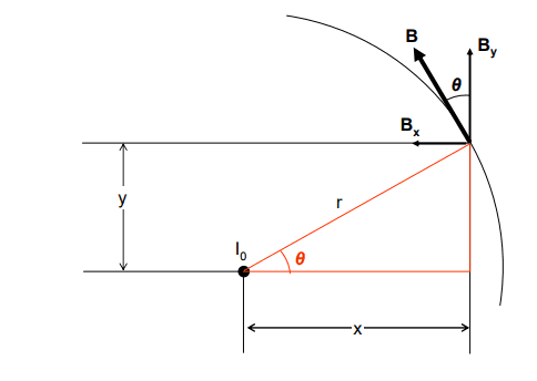

Hi all, good thread for a newbie like me. I studied the document @jim hardy posted in post #6 and got one question to ask regarding the document.
Document link: http://www.emfs.info/wp-content/uploads/2014/07/Howtocalculatethemagneticfieldfromathree.pdf
Everything is clear until page 4, up til they write "We now need to resolve each current into an in-phase and an out-of-phase component. We do this using a phasor diagram:" Why is this step necessary?
We can calculate the magnitude of [itex]\vec{B}(t)[/itex] at point P using:
[itex]B_n(t) = \frac{\mu _0 i_n(t)}{2\pi r_p}[/itex]​
We now have the magnitude of [itex]\vec{B}(t)[/itex] (see figure below, which is from the pdf document linked in post #6)
To get [itex]B_x(t)[/itex] and [itex]B_y(t)[/itex], we do the following:
[itex]B_{y}(t) = \vec{B}(t) cos(\theta)[/itex] and [itex]-B_x(t) = \vec{B}(t) sin(\theta)[/itex] (minus sign based on the figure)​
Now we have the x and y component of [itex]B_y(t)[/itex] from let's say phase A, we can do the same for phase B and C, just remember to use proper distance [itex]r[/itex], proper angle [itex]\theta[/itex] and proper value of [itex]B_{a,b,c}[/itex].
To get the magnitude we can do:
[itex]\vec{B}_{resultant}(t) = \vec{B}_a(t) + \vec{B}_b(t) + \vec{B}_c(t)[/itex]
or if we just care about the magnitude and not direction
[itex]B_{resultant}(t) = \sqrt{(B_{a,x}(t)+B_{b,x}(t)+B_{c,x}(t))^2 + (B_{a,y}(t)+B_{b,y}(t)+B_{c,y}(t))^2}[/itex]
Doing it like this I do not have to worry about resolving each current into an in-phase and an out-of-phase component like shown in the pdf document.
Appreciated if someone could look over my calculations and tell me if this resolving of currents is necessary or not.
Thanks

  • #34
@Bavuka The phasor diagram method can perhaps be better explained with trigonometric calculations: ## \\ ## If we begin with ## A cos(\omega t)+Bcos(\omega t+\phi)=Acos(\omega t)+B(cos(\omega t)cos(\phi)-sin(\omega t)sin(\phi)) ## which can be written in the form ## S=Ccos(\omega t)+Dsin(\omega t) ## by grouping terms. There is an algebraic trick that is used next: ## \\ ## ## S=\sqrt{C^2+D^2} [cos(\omega t) \frac{C}{\sqrt{C^2+D^2}}+sin(\omega t) \frac{D}{\sqrt{C^2+D^2}}]##. ## \\ ## This can be written as ## S=Ecos(\omega t-\theta) ## where ## E=\sqrt{C^2+D^2} ## with ## cos(\theta)=\frac{C}{\sqrt{C^2+D^2}} ## and ## sin (\theta)=\frac{D}{\sqrt{C^2+D^2}} ## so that ## tan(\theta)=D/C ##. (Recall the trigonometric identity for the expansion of ## cos(\omega t-\theta) ##).## \\ ## The process here to do this calculation was to divide the terms up into ## cos(\omega t) ## and ## sin(\omega t) ##. We did it for just two ## cos(\omega t +\phi) ## terms, (the first one has ## \phi=0 ##), but you could do it for any number of them. In the problem at hand (the three phase electrical system with ## \omega =2 \pi f ## and ## f=60 \, Hz ##), we have 3 signals: one with ## \phi=0 ##, one with ## \phi=\pi/3 ##, and one with ## \phi=2 \pi/3 ##.

  • #36
[ I haven't forgot you, just this one was going to take some study and i had to use daylight to finish putting side back on the barn. ]
I think Charles did a better job with the algebra and Latex than i could.
If i understand your question the answer is simple -
It's difficult to add in polar notation . I don't know how to do it.
One of the three flux's X components is of the form Asin(ωt) , one is Bsin(ωt-120°) and one is Csin(ωt+120°).
A, B and C differ because of the different radii from observer to each phase of the transmission line..
likewise their Y components.
⃗Bresultant(t)=⃗Ba(t)+⃗Bb(t)+⃗Bc(t)
once for X components and once for Y components ? Sure,
but because they're 120 degrees apart
I'd have to convert them EDIT to polar from polar to rectangular notation to add them.
(please pardon misspelling of rectangular , )
same exercise for Y components.
Maybe you know some math shortcut that i don't.
old jim

  • #37
OliskaP said:
Thanks for the replies. I looked at a table which showed typical values of B at a distance x from a 420 kV transmission line, and they were not zero. So if I would want to calculate the value of B below the transmission line at ground level, I would have to use Biot-Savart equation on each conductor and sum them up?
Yes.
Ampere's law gives the total integral of the B field (actually ∫B⋅ds) surrounding one or more current-carrying wires. But if the wires are separated you lose symmetry and the value of B will vary as you go around any amperian loop.
