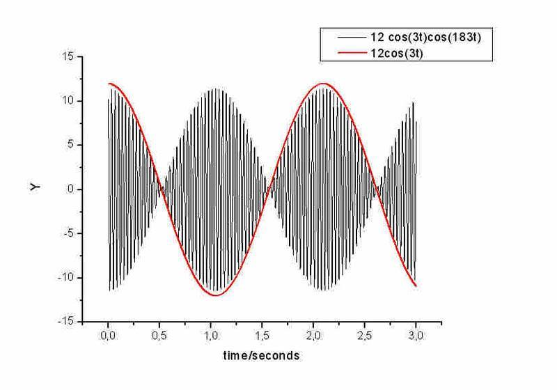

See attachment, it is your wave. Does it look a wave with its amplitude changing with angular frequency ω=3 rad/s or a wave with amplitude varying with ω=183 rad/s?

Thank you for the graph but that does not explain why one term defines the change in amplitude and not the either.
If you looked at the higher angular frequency curve as defining the amplitude, because the other factor has such a lower angular frequency it doesn't "fill up" the the other curve, in fact you can't even detect it, so in general the factor with the lower angular frequency defines the amplitude of the resultant wave?
The low frequency curve is the envelope of the high frequency one. During one period of the lower frequency curve (the red one) there are a lot of maxima and minima of the high-frequency wave. But these maxima and minima change with time. We call "amplitude" the extremal deviation from zero. You can define amplitude for the high frequency curve during anyone of its periods, but it is impossible to find a single minimum and maximum during one period of the low-frequency curve. That is why we say that the amplitude of the high frequency curve changes.
To consider the product of two waves as one wave with varying amplitude is justified only in case when the frequencies are very different in magnitude.

Thank you, I think that answers the question pretty well.
