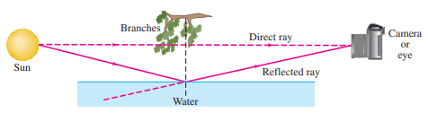

Answer from the book:
We need to draw two diagrams, one assuming the photo on p. 644
is right side up, and another assuming it is upside down. Figure 23–9 is drawn
assuming the photo is upside down. In this case, the Sun blocked by the tree
would be the direct view, and the full view of the Sun the reflection: the ray which
reflects off the water and into the camera travels at an angle below the branch,
whereas the ray that travels directly to the camera passes through the branches.
This works. Try to draw a diagram assuming the photo is right side up (thus assuming that the image of the Sun in the reflection is higher above the horizon than
it is as viewed directly). It won’t work. The photo on p. 644 is upside down.

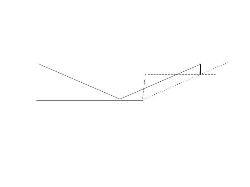

The sun's reflection is further from the horizon than is the reflection of the people. Therefore the angle to the horizontal that the shadow takes from the heads of the people is greater than that of the reflection. This means the shadow can fall short of the shore but the line of the reflection does not.
Ray diagram of a water surface (horizontal line) with a reflected light path from a figure on the far bank to an eye on the left, plus two candidate bank profiles: dashed and dotted.
In the diagram, the horizontal blue line is the water surface, the short thick vertical to the right is a person on the far shore. The angled solid lines are the light path from that person's head via reflection to my eye on the left.
Two possible land forms are shown for the far bank.
The dashed line rises steeply then runs level. I can see the person directly but not by reflection.
The dotted line rises slowly but continues up past the height of the person. I can see the person's reflection against the reflection of the sky, but viewed directly the person is invisible against the dark background.
Having proved from the evidence of the sun and intervening tree branch that the photo is upside down, we can infer that the dashed line may be correct but the dotted line cannot be.
