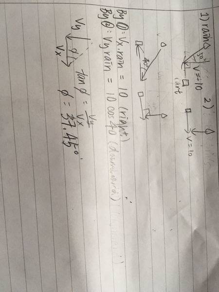

This is how i do with reference to Empirical Wizardry...
Hope i didn't misunderstand what u mean...
To be honest, it is quite abstract to imagine the tan theta part...
However, i got a different answer from you... can you share how you do in a more detail way please? Or point out what i have done wrong please? Thank you.
Ps I haven't got the model answer..

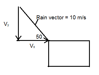

You have used 10cos(50) to get the horizontal velocity. This requires that the velocity of the rain vector to be 10 m/s. How did you determine the rain vector to be 10 m/s ?
The diagram below shows what you have calculated:
We don't know that the magnitude rain velocity vector is 10 m/s We know the cart has a velocity of -10 m/s, in this case where it is moving to the left.

I thought only the rain is always moving in the same Vx in same direction (positive) as the cart would give 90o strike, isn't it?

IMPORTANT NOTE: I totally missed that its the angle from the normal. You're right it should definitely be 40 degrees. That should replace the 50 degrees in the diagram I had earlier above. Apologies!
