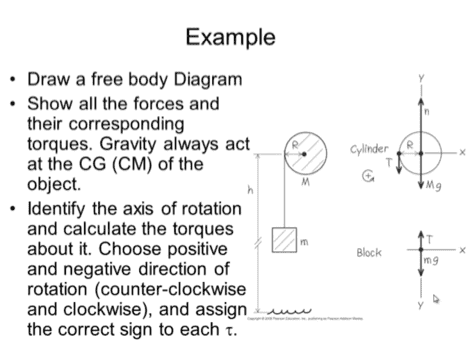

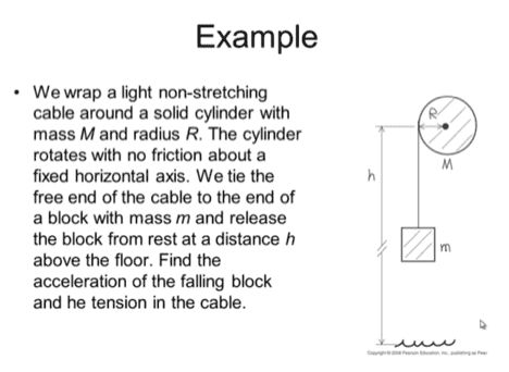

Slide diagram of a pulley-and-block setup: a solid cylinder of mass M and radius R on a fixed horizontal axis, with a cable from its rim hanging down to a block of mass m a distance h above the floor.
Slide titled Example with bulleted instructions to draw a free body diagram and identify the axis of rotation. Right side shows a pulley with radius R and mass M hanging block m, plus diagrams of a cylinder with forces T, Mg and n, and a block with forces T, mg and n, with x and y axes.

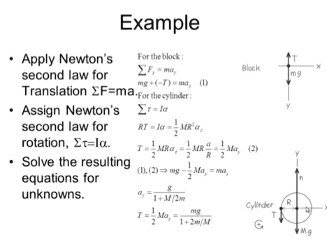

Slide titled Example listing steps: apply Newton's second law for translation, assign Newton's second law for rotation, solve the resulting equations; with equations mg + (-T) = ma_y, RT = Iα = (1/2)MR²α_z, a_y = g/(1+M/2m), T = (1/2)Ma_y = mg/(1+2m/M), beside a block with T and mg and a cylinder with radius R, T, n and Mg.
This is not really a question on how to solve the problem, I'm just trying to get clarification on something. For angular acceleration, α, can someone explain to me what αz is? And why does αz = α / R = αy? I understand the rest of the problem, I just don't understand where or what αz is and how αz = α / R = αy. Thanks in advance for any help given!
##\alpha_z## apparently represents the angular acceleration for rotation about the z-axis.
The print in the picture is small and hard to read. In equation (2) I think it states that ## \alpha_z = \large \frac{a}{R}##, not ##\alpha_z = \large \frac{\alpha}{R}.##
Ohhh, you're right about the a/R not α/R. But can you explain to me why does a/R = ay?
They aren't claiming that a/R = ay.
The R cancels: (1/2)MR(a/R) = (1/2)May. The "a" on the left is the same as ay.
Ok I see. And just to clarify, if I divide a linear acceleration by the radius R then we get angular acceleration?
