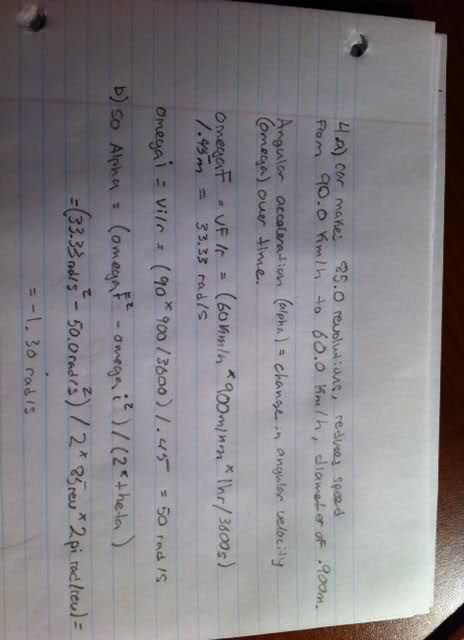

Question:
Each of the tires of a car makes 85.0 revolutions as the car reduces its speed uniformly from 90.0 km/h to 60.0 km/m, The tires have a diamater of .900m.
Find initial and final angular Velocities
Find the angular acceleration of tires in rad/s^2
My answers: Please tell me if that's right, because I have NO idea if its correct.
If I am interpreting your work correctly, you are changing the km to m by multiplying by 900 instead of by 1000.
I think that the rest is OK.
Oops lol
Where wherever I have 900, change to 1000 correct? Just to be sure :)
Because when I change that, I get -1.60 is that correct for this question?
Because someone told me they got -4.88 ?
I got angular acc = -1.605rad/sec^2.
