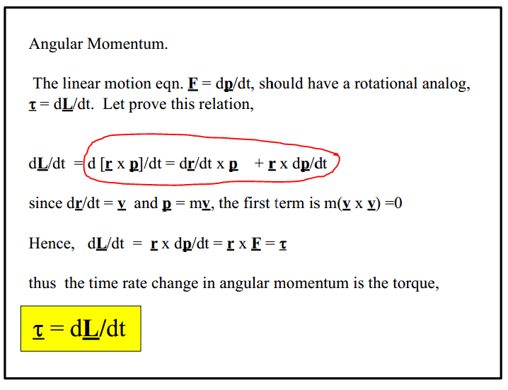

Hey all, I'm not understanding why the bits highlighted in red are equal? Any help appreciated, thanks.
It's just the product rule for derivatives, d(a*b) = da*b + a*db.
Likes NotASmurf
Thanks you
