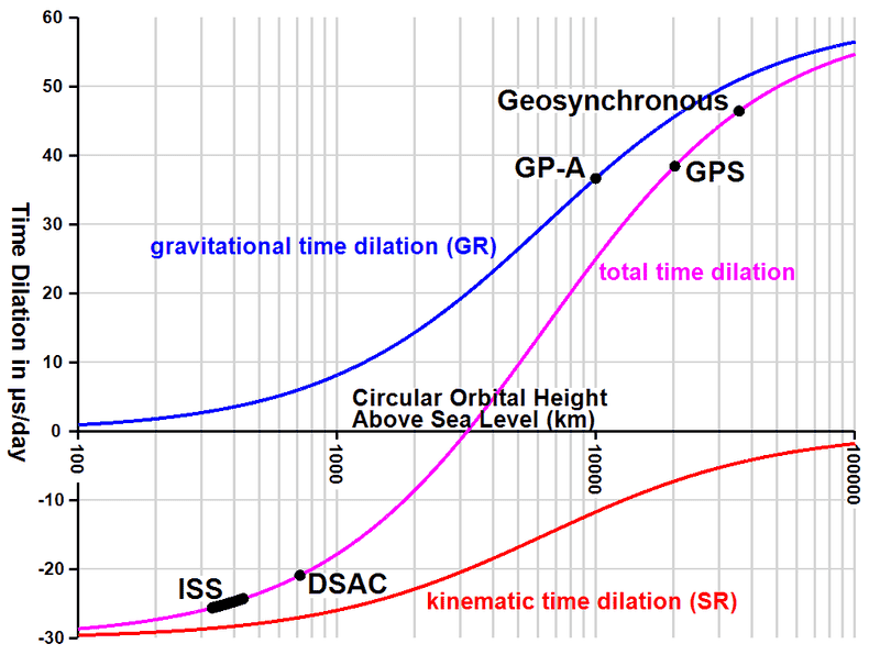

Time moves faster when higher above the earth. Time move slower the faster you are moving. A geosynchronous satellite has to be very high to be geosynchronous so it's time should be fast, but it also has to be orbiting the earth extremely fast to keep up with a geosynchronous position, so it's time should be slow. This seems like a paradox to me.

Why? It's just two competing effects.
In that case the gravitational effect wins over the kinematic effect
Free-fall orbital speed decreases with altitude.
