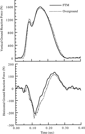

When we started drawing FBD's I realized the force that a runner exerts on a ground is (ideally) vertical unless the runner is stopping or starting. My roommate disagreed with this conjecture, but seemed to acknowledge that IF the force is only vertical, it would be impossible for the treadmill to "help" the runner. So he found a source that contradicted my idea.
If we put my roommate out of the picture, there is still a disagreement between Professor Sprott and me. The linked source says,
"For the running case, the force is impulsive (it occurs over a very short time interval), and it is thus much larger than the person's weight. Furthermore, to launch the person at a 45° angle requires equal vertical and horizontal forces." (it's under "friction requirements")
He's saying that a horizontal force is required to propel a runner forward with each stride. I remember this is how my physics teacher taught us (though it was a qualitative example), and I say it's wrong. Is the accepted model for running one that agrees with my physics teacher and Prof. Sprott? If so, it's WRONG!

What I don't understand is why - regardless of what forces are required or invoked - it would be any different between ground and treadmill.
When we do calculations in a spaceship traveling to Mars, do we determine the forces relative to Earth? The whole point of inertial motion is that it is not relevant with the system (runner and ground) what the walls of the warehouse happen to be doing.

With the treadmill vs running on ground thing there can't be any difference because if you extended the treadmill band out infinitely and had it move relative to you then your motion in the frame of reference of the band is exactly the same as that from the frame of reference on the ground if you were running without a treadmill.

Note that once you are moving, Newton's 1st law demands that all horizontal forces sum to zero. So the only net/external forward force you provide is against wind resistance.
The vast majority of the energy expended while walking or running is in supporting (or bouncing!) yourself against gravity. And the longer your stride, the lower the angle and therefore the greater the force.

Yes, and the reason you have to push yourself forward is because the "landing" involves some acceleration in the negative direction. You're removing some of your 1st law motion with each "landing" which then is replaced on the "leap". The slower you run, the worse that is, and the faster you run the more 1st law advantage you have in keeping everything above the waist in motion, (while accelerating the legs becomes harder and harder because that has to be done faster and faster).

My last post got me thinking. The horizontal force would be necessary because you are accelerating the opposite leg forward essentially horizontally. Since the opposite leg's motion is essentially horizontal, the leg in contact with the ground has to counter it horizontally. While the center of mass is in continuous motion the legs are constantly applying force against their horizontal inertia. Legs have a lot of mass relative to a body. This is not a negligible amount of force at all.
it's just badly stated. The force does not propel the runner, it propels the runners legs only (disregarding air friction and stride irregularities).
You have to accelerate your legs to run and that force is significant to move your legs but you are not propelling the runner, you are propelling the runner's legs. The rest of the body, pelvis upward, is already moving and will keep moving.
This is why, when you trip, you go down face first. Your feet stop because of friction but the rest of you keeps moving forward until friction stops you from moving. Personal experience - a colleague was running down a smooth hall carrying a load of tests for a class. She tripped, fell face first, and slid probably 15 feet before stopping.

Unless you're talking about counteracting air resistance, there's no need for a horizontal frictional force when running with good form (with walking it's pretty hard to walk without exerting a significant breaking force, which would mean a propulsive force would be required somewhere in the stride). You would continue inertially until acted upon by a horizontal force. Friction doesn't allow you to continue moving, it allows you to regain speed after it slows you down. The real use of friction when walking or running is stability (and counteracting air resistance).

At speed, the only horizontal force sprinters need to exert is a force to overcome air resistance. Good sprinters won't exert any breaking force when they land. Runners with good form also won't exert a significant breaking force even if they're running at an easy pace.
If this were true (that you don't need to impart a horizontal force to keep moving) then runners could adopt a simple pogo-stick style of running - doing nothing but providing a direct downward force to keep them off the ground.
Go look at the footprints in a wet track. The surface most definitely experiences a strong backward push from the runner.
I run barefoot quite a bit and my footprints aren't distinguishable from those of a walking barefoot person (except by their spacing), or from someone who wasn't moving at all and just make a foot print.
What would this pogo-stick style of running look like? With regular running with no air resistance, you are providing nothing but a downward force.
That isn't possible: your foot is not directly below your cog, so it must apply substantial horizontal force as well.
I would also argue that some amount of forward motion is lost when your foot contacts with the ground.
Well, this can't be proven or disproven. I should not have introduced it. Frankly, I was hoping you'd simply see the error of your ways.
I simply do not know how you can possibly think this.
Again, if it were true, there would actually be no point in moving your legs in a circular motion, you could - as I said - simply push up and down like a pogo stick.
In fact...
in fact - if, as you claim - the motion of your legs imparts no horizontal force to help you walk/run, then it would not matter which way you rotated your legs. You could rotate your legs backwards (as if running backwards) and it would not slow your forward motion.Alternately, if you were nudged up to speed so that you were set in motion going backwards at 5mph, you should be able to run forward full-tilt and yet it would not slow your backward motion.
Do you not see the absurdity of your claim?
luigidorf said:
When a runner lifts his knee up after pushing off, the other leg goes back, so the center of mass isn't disrupted. By moving the leg back (not exerting a horizontal force on the ground), the center of mass of the legs (and therefore the entire body) is balanced and it allows everything to move smoothly. If the runners legs were accelerating and his body wasn't, the runner would be broken apart at the torso. The legs would continue increasing velocity, and the torso would plummet to the ground with nothing to support it.
You're forgetting that acceleration includes change of direction. The leg that is supporting the runner's weight is moving backward. Then the weight shifts and the runner has to exert force to change the direction of motion of the leg that was just moving backward. He has to bring it forward relative to his center of mass. The horizontal motion of his legs happens independently of 1st law conditions that apply to his torso, etc. Look at it this way: his feet are always in a different inertial frame than the rest of him. Half the time they're at rest in the ground frame, the other half, they're in a third frame moving forward faster than his COM.
