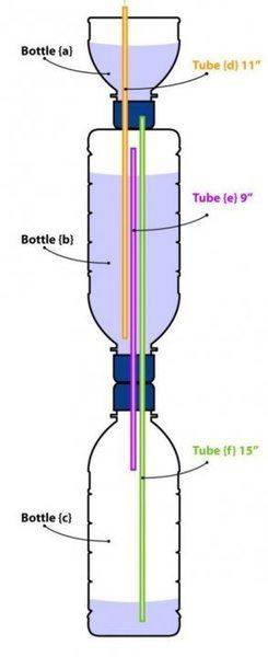

What will happen? And why?

I'm assuming that bottle a is open at the top. Water from bottle a will move into bottle c, causing the air pressure to increase in bottle c and b. This will cause the water level in tube d to rise until it equals the level of the water in bottle a.
If a is not open, then nothing will change.

An interesting puzzle. Without doing a very detailed analysis, I think the air pressure in bottle c will build up from water dripping down through the straw from bottle a. Bottle b will have this same pressure which will easily be sufficient to cause water to flow up the 11" of tube "d" and thereby work its way down to bottle c. Bottle b will be nearly emptied, until it no longer has a connection to tube d and all the water will wind up in bottle c. Near the end though, water will flow up the 9" tube e into bottle b and into the bottom of bottle b and up tube d. I don't quite have a complete solution yet. Thank you @micromass . I will need to give it a little additional effort. The finish could be a little tricky.

I think that counter-intuitively the approximately 15" height of water pressure in tube (f) will be transferred to the air at the top of bottle (b) and that will be enough to lift water up tube (d) back into the top, as suggested by @Charles Link, causing (a) to remain at an approximately constant level. The overall initial effect is then to transfer water from (b) through (a) to (c).
I think this will end soon after (c) becomes sufficiently full that the water level in (c) passes the bottom tube (e), as after that point the back pressure due to the water in tube (e) will prevent the pressure in (b) from being sufficient to lift any more water up tube (d). It will then end with (a) containing a similar amount to when it started, (b) containing a similar small amount and (c) being full up to the bottom of (e). However, that all depends on the exact relative capacities which are not clearly indicated.

This may be naive, but (assuming A is open at the top) isn't it essentially a manometer with a couple of air bubbles? So the answer is that the water level in the yellow tube must reach the same height as the water in bottle A. The details would surely depend on the initial pressure of the air in B and C.

The blue tube connecting the air in bottle C to the air in bottle B makes it so that things will not reach the same level in bottle A. The blue tube could be 10 ft. long and the air pressure at the top of it (bottle B)would be essentially the same as the pressure at the bottom (bottle C). This makes an extension of the system. I believe the 11" length of tube d was chosen to be less than 15" so that water in bottle B would necessarily go through it and spill over from it even if the length of the blue tube was several feet long. (Another bottle could be put in the system (call it bottle D) (similar to bottle B) that the blue tube feeds into at a height several feet above this system. The water would go up an 11" tube from this bottle (because of the 15" length of tube "f") and spill right over. Clearly the water would not be at the same level as Bottle A.)
Assume the system is in equilibrium initially. Water added to a would go into c via the green, increasing air pressure in c. Displaced air would be transferred to b via the pink. This would exert pressure on the water in b, which would flow up and out through the yellow. What goes down must come up.
