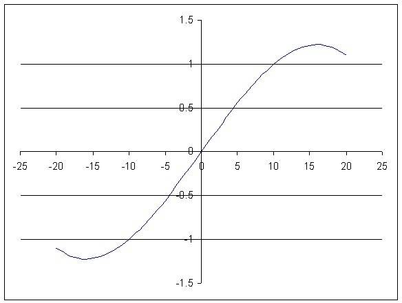

Also... my Cl doesn't seem to tail off towards 16 degrees
Try CL = -.0001497 AOA3 + .11497 AOA
CL = -1 at -10 degrees, +1 at +10 degrees, peaks at -16 and +16 degrees:
