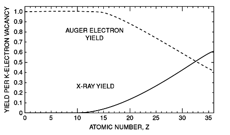

Auger electrons
Dear Eric,
Thank goodness I am now off clinical duty and in my office studying as I enter the home-stretch toward my exam!
My next question is about Auger electrons:
Bushberg states: "An electron cascade does not always result in the production of a characteristic x-ray. A competing process that predominates in low Z elements is Auger electron emission...The probability that the electron transition will result in the emission of a characteristic x-ray is called the fluorescent yield. Thus, 1-fluorescent yield is the probability that the transition will result in the ejection of an Auger electron...The K-shell fluorescent yield is essentially zero (<1%) for elements Z<10 (esp. soft tissues), about 15% for calcium (Z = 20), about 65% for iodine (Z = 53), and approaches 80% for Z >60."
Specifically, the wording of the sentences regarding fluorescent yield is too abbreviated and does not help me “read between the lines”. Can you please explain the probability of fluorescent yield in these lower Z atoms? I can memorize those percentages readily, but I do not understand how those numbers were generated to be able to answer a more complex question. I know I will be asked about this.

As you said, after an electron cascade you have two competing processes for energy release, characteristic x-rays and Auger electrons.
Auger electrons tend to be ejected from a shell that is very close (the same or adjacent) to the shell that the atom's electron "fell in" from to fill the original vacancy. That is, if you have a K shell vacancy and an L shell electron filled that vacancy, the Auger electron will almost always be ejected from the L shell (LI, LII, LIII may all be possible).
A semi-empirical result is that Auger electrons emission is favored when the difference between energy states of the involved shells is small. Difference in energy states grows as atomic number (Z) grows. As an example, consider the numbers below:
Oxygen K shell binding energy = 543.1 eV
Oxygen LI shell binding energy = 41.6 eV
Difference = 501.5 eV
Lead K shell binding energy = 88005 eV
Lead LI shell binding energy = 15861 eV
Difference = 72144 eV
Therefore you get the result that you posted in that Auger electrons are more prevalent for low Z (low energy difference) atoms compared to high Z (high energy difference) atoms.
Fluorescence yield "picks up" where Auger electron emission falls off as atomic number increases, so you get increasing fluorescence yield % as Z increases, like in the example numbers you posted. See the attached image below.
Hope that helps somewhat. I'm not a quantum mechanics expert, and you would probably have to get your hands dirty in something like that to really get a complete understanding of why one thing is favored over another and how that changes with atomic number.
All I can really offer is a qualitative explanation and some empirical results.

Eric,
Thank you very much for the reply. I remember being asked a question on the exam last year about why Auger vs X-Rays but I had no idea. Your explanation more than suffices as the examiners are not quantum physicists either. I have never seen that graph before showing the propensity for one condition over the other. :) It is printed and stuffed in my book. Back to cramming...
Erica
