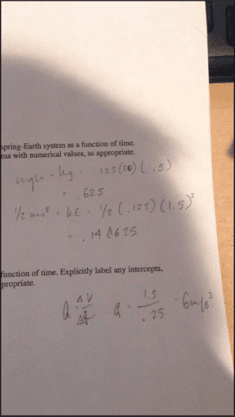

Data is mostly from graphs so I had to put it in a pdf. Other given data : m=0.125kg
Variables : m(mass), v(velocity), j(energy), t(time), a(acceleration)
F=kx
PE=mgh
a=v/t
My work and solutions are all in these links, it's hard to type it out and stuff due to graphs
[/B]
http://imgur.com/Q1MKKuB
http://imgur.com/WpjOnU9
http://imgur.com/j2PwDAo
http://imgur.com/7XtxiZl

I am sorry about the picture rule, but yeah, could someone help check my work and correct any errors?
PS I have changed some stuff,
Part (A) changed minimum to 1.08 and maximum to 1.225 and the wave is from the middle line to the top line
Part (B) changed acceleration to 3pi, so maximum is 3pi and minimum is -3pi. Got this using derivatives and my teacher wants me to do it the basic "conceptual physics" way using algebra, but I am not sure how

Part (A) I got as far as finding the KEmax. I equaled it to 1/2mv^2 and plugged in data from the given graphs above (A), : v=1.5m/s and m=.125 and I ended up with a KE of .14. It then asked to sketch a graph of "the potential energy of the object-spring-Earth system as a function of time" I am not sure if I did it right, but my graph is shown in the imgur links.
Part (B) I used derivatives to find the acceleration of 3pi, but I believe my teacher wants us to use the conceptual algebraic way of Physics. Not sure how to do that though.

Here's one way.
Forget the given problem for a moment. Write a generic SHM equation for position as a function of time, putting in symbols for the amplitude and frequency parameters. The max value of the position is the amplitude. Differentiate it to get the velocity as a function of time. What is the maximum value of this? Differentiate again to get acceleration, and again extract an algebraic expression for the max value.
Compare the three algebraic formulae you have for the three maxima. What relationship do you notice?
