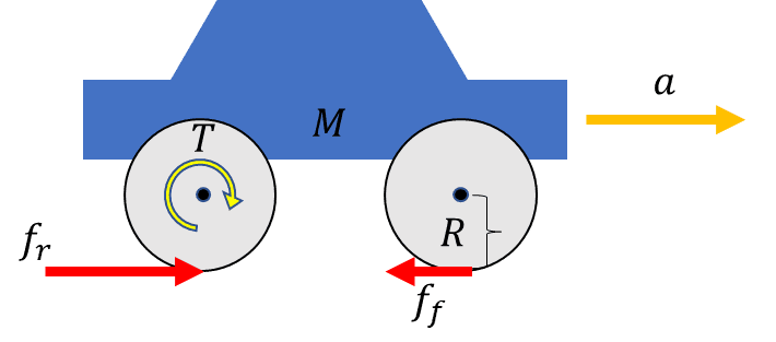

erobz said:
Picking up with Work/Energy replacing the LHS by the work done by a constant torque ##2T## ( ## T## is applied to each wheel).
$$ \implies a = \frac{2TR}{mR^2 + 4I} \tag*{} $$
This and the system of equations in #10 using Newtons Laws yield equivalent results.

However, considering the equations in #10 which appear to be equivalent, the net force on the car is the friction force. They seem to be different sides of the same coin.
They are in fact exactly that and they are consistent. There is a net external force on the car provided by the difference in the rear ground-tire friction and the front.
erobz said:
So, what you are saying the result of #10 being equivalent to #24 is a happy accident? I must consider some unknown force as pushing on the axles to solve the problem (namely F_a in your analysis)?
There is a net external force on the car provided by the difference in the rear ground-tire friction and the front. This does not say that the ground does work on the car because the cantact point is static. The contact point is static because the car is not a rigid body and is continuously deformed by the engine (it takes energy to make the rear wheels turn. There is also some external "rotational friction" as expertly detailed by @jack action. But the motive energy does not come from an external force. It is internal energy from the long ago sun channeled through dead dinosaurs.
There is no unknown force required: this is not a rigid block.

$$ F_{net} = 2(f_r - f_f) \implies \delta W = \int F_{net} \, dx $$
Which should be equivalent to what I've shown in #24. Yet the static frictional forces apparently "do no work" on the vehicle.

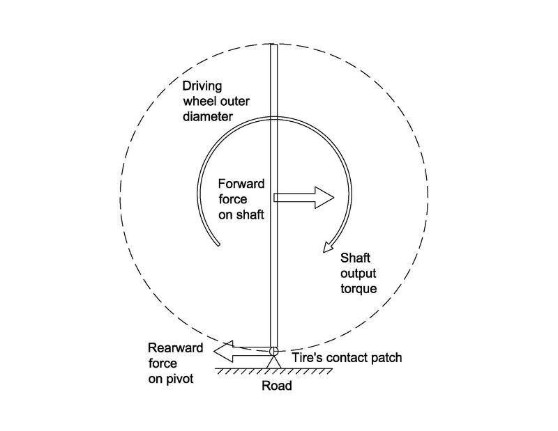

I'm fine with all of that. Is this all just a semantical argument based on the scope of the model? @jack action seems to be saying that the static frictional forces do work on the vehicle. I think they do too.
So does Author Giancolli: Its right in the text of the problem. The friction forces ##F_1## and ##F_2## decelerate the car.
The force moves with the vehicle and hence has a displacement. The static friction force does work to slow the vehicle.
@hutchphd say its "dead dinosaurs" that do the work, but not the friction. I can see a perspective where that is true too. The dinos act through the engine which provides the torque! Should people really be getting frustrated with me over this?

Respectfully, I believe that the idealized friction force between wheel and surface does as much work as the reactive force at the pivot of a see-saw or at the hinges of a door: zero.
If you grab the top edge of one door of your kitchen cabinet, halfway between the hinges line and the vertical edge, and exert a twisting force (zero translation), the door will rotate about the hinges, dragging your twisting hand along a circular trajectory.
Now, think of the hinge's line like the contact patch of our tire, the halfway top of the door as the location of our axle, and your twisting effort, like the energy inducing the door's swing.
Applying calculus:
As the number of hinged doors (and/or horizontal length of the door) tend to infinite, the translation trajectory of your hand tends to linear (just like for the actual axle).
IMHO, the only work that the friction force can do in this case, is to heat up the rubber of the wheels, when slipping, skipping and deforming carcass of the tires exist.

Starting off a torque, what does work should be a pair of forces (couple).
Both forces induce movement of the points that are free to move about the point that is unable to move (pivot, instantaneous contact patch).
Please, see:
https://en.wikipedia.org/wiki/Couple_(mechanics)
The driving entity could be a shaft output torque (as represented), or a tangential force applied on the top of the wheel (as when you have to push a heavy car and you push with your hands located on the top of one tire and use mechanical advantage of 2 to do it).

I want this to be over as much as anyone else. So I'm going to be as concise as possible about what I find confusing still:
$$\int F_{net} \, dx = \int 2 \left( f_r - f_f \right) dx = 0 $$
Will anyone explain this?
  • #54
Simple. Its wrong. Are we done? Is it copied from somewhere (perhaps I miss a nuance) ?
  • #55
No, it's not copied. It is the sum of forces in post#10. What is wrong about it? Static friction does zero work. Certainly that implies what is above?
  • #56
No, it implies the work done by one force is equal and opposite to the work done by the other force, thus the acceleration is zero, thus the velocity is constant. It's like having a container with two holes, filled with water. If water gets in one hole as much as the water gets out the other one, the water volume in the container stays the same.
The only case where there wouldn't be work done is if the vehicle's velocity is zero. Like if no water got in or out with our container example, even though there would be pressure present at the holes.
But as long as it moves, work is being done, even if it's "negative work" (Remember, work is defined as the dot product of two vectors). The rear [driven] wheels add energy (positive work) to the vehicle, and the front wheels remove energy (negative work) from the vehicle. Since they both have the same velocity (from the vehicle), It must then mean that the net force acting on the vehicle is zero.
  • #57
But acceleration isn't zero.
$$a = \frac{2TR}{mR^2+4I}$$
This is the solution to the system in #10 as well as Work/Energy in #24.
  • #58
I told you in post #37 that the ##T## in that equation represents the net torque, i.e. it might be zero.
  • #59
No, you are evoking forces that are not present in the idealization of #10. You are unwittingly setting up a strawman argument to knock it down. This is a simple physics problem. Fundamentally it's about an exchange of energy. It does not require the extra complexity of drag, rolling resistance, etc.. you are attempting to add in #37. It is a foundational argument. ##F = ma##
it might be zero.
This is not an argument. It might be ##|a|>0##. What is your point? You are flat out telling me the car can't accelerate under the action of constant torque, because it is not easy to explain otherwise.
  • #60
So you think that the torque input from your engine is completely transferred to acceleration, regardless of the other forces acting on the vehicle? If the front end of your vehicle is resting against a wall, do you think that having a rear wheel torque will give your vehicle an acceleration?
Before anything else, you must first admit you are wrong. The proof is that even you can see that your modelization gives results that don't make sense.
There are two ways that you can model your vehicle:
  1. You assume the vehicle as a whole block with forces acting on it, and you do a single FBD;
  2. You assume the vehicle as three blocks - one body & two axles - and you do a FBD on each of them.
The way you are doing it - one block with two free rotating axles in a single FBD - is not good. It doesn't give results that make sense. It's not used anywhere, ever.
I would tell you to do the FBD correctly and get back to us, but I already did it for you, for each method. All you have to do is accept that these are the right methods to do the work properly and try to understand them.
If you have further questions to help you understand, I'll be glad to answer them.
