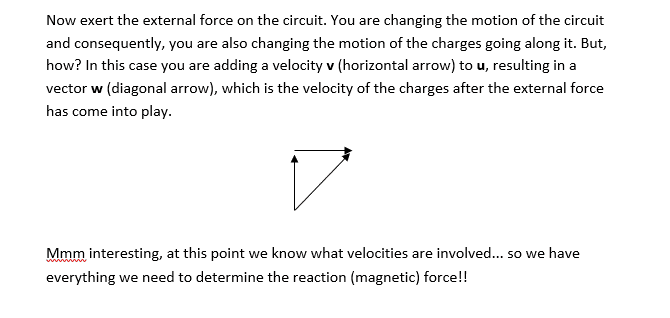

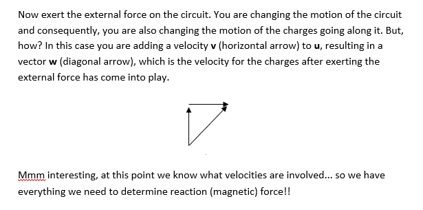

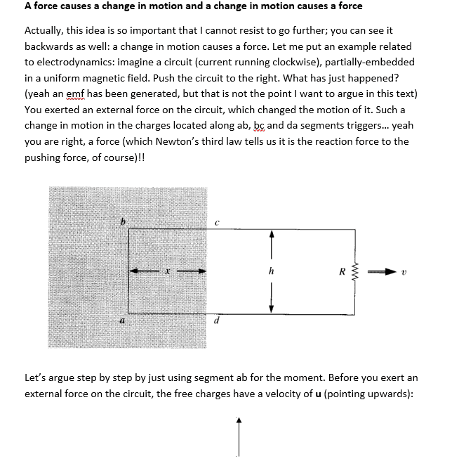

I am writing about the nature of force in classical mechanics and what does really imply, in terms of change in motion. I am using as an example a circuit, on which we exert a force.
Circuit schematic of a rectangular loop abcd partially in a shaded magnetic field region, with a horizontal segment ab of length x, a resistor R on the right, and the loop moving to the right at velocity v.
I am trying to justify the following scheme (concretely, ##f_{mag}##):
Vector diagram: velocity u points up and velocity v points right, summing to w at angle θ from u. Magnetic force f_mag points left-up, with components vB vertical and uB horizontal, and f_pull points right.
Handwritten-style diagram of two vectors: a horizontal arrow labelled v on top of a diagonal arrow labelled w, with a vertical arrow labelled u, forming a vector addition triangle.
The thing is that I am wondering how can I justify ##f_{mag}## by using vector addition, based on Newton's Second Law (as neat as possible). I know that it can be justified by Lorentz Force Law (force has to be perpendicular to the displacement, as magnetic forces do not work) but that is not what I am looking for.

Firstly, no need to use vector addition rules, scalar equations are just fine.
Secondly, to understand what's happening when you pull a wire loop out in the presence of magnetic field, Newton's laws are not enough, you need electromagnetism, or at least Faraday's law of induction and Ohm's law.
Let me explain. Let's, for start, remove the resistor from the loop, i.e. make the loop open.
If you pull on the open loop, there will be an EMF induced in the loop, the value of which would be ## EMF = \frac {d magnetic flux}{dt} ## but will there be any force? absolutely no. The loop is open, there is no current flowing and, therefore, no force.
Now, put the resistor back in and pull the loop again. Now, the induced EMF creates a current in the loop of the value ## \frac {EMF}R ##, the current flowing in the wire in the presence of the magnetic field creates Lorentz force which tends to oppose the direction of motion of the loop (Lenz law). How strong is the force? well, it depends on the value of the resistor. The smaller resistor, the bigger the current and the bigger the force.
