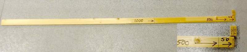

And finally, they are also problematic when you want to quote more than one digit on your error- e.g. 15.54 +/- 0.12 is a perfectly reasonable distribution but there is no way of writing this using significant figures only. You aren't allowed to round the data for no reason,
I am curious to know what measurements in what experiment resulted in a number to be quoted like this.
To show what this number 'looks like' I will rewrite the number as 1554 +/-12 (to avoid messing about with the decimal point)
I have taken this to represent 1554mm +/-12mm and cut a wooden slat to show the number on a line.
I wonder what application in practical physics would find this number, represented as it is, to be useful. I cannot see that the +/-12 (mm) has any significance.
The only thing I could think of is perhaps the height of a stack of 12mm blocks was measured, found to be 1554mm and the number of blocks in the stack was calculated. If the count was thought to be out by 1 block that could be expressed as +/-12mm.
Or perhaps 12mm represents a wavelength and a different sort of counting (of wavelengths) was involved.
For me the moral is...LOOK at the number, each digit to the right is 10x smaller than the one before...how many moves to the right do you need to make for the number you meet can be considered to be 'insignificant'...for most everyday physics I would say 3 or 4 at the most.

  • #53
How do you know that you've cut the wood to 1554 mm? Would it be fair to say that you're not entirely sure that it's 1554 mm?
  • #54
You have hit the nail square on the head ! The numbers in the post I quoted (#49) were 15.54+/-0.12 and I would say the same question should be asked here.
My piece of wood was cut with care but it was to illustrate the idea, I could equally easily have just done a sketch.
You see the +/-12mm block at the end, it 'swamps' the last figure (4).
You have highlighted the need to be aware of the significance of significant figure !
  • #55
I was responding to this:
If for the sake of argument we assume your ruler, or whatever instrument you used to place the 1554 mm mark for the cut, is exact.
You might be a good craftsman with a saw, but you're probably still going to cut off a bit too much or a bit too little here and there. If you had a production of these wood pieces, you might take a large random sample of your work and conclude on the basis of this sample that you're able produce lengths between 1542 and 1566 mm with a mean of 1554 mm.
Wouldn't you find it significant to include a measure of this accuracy for your customers?
